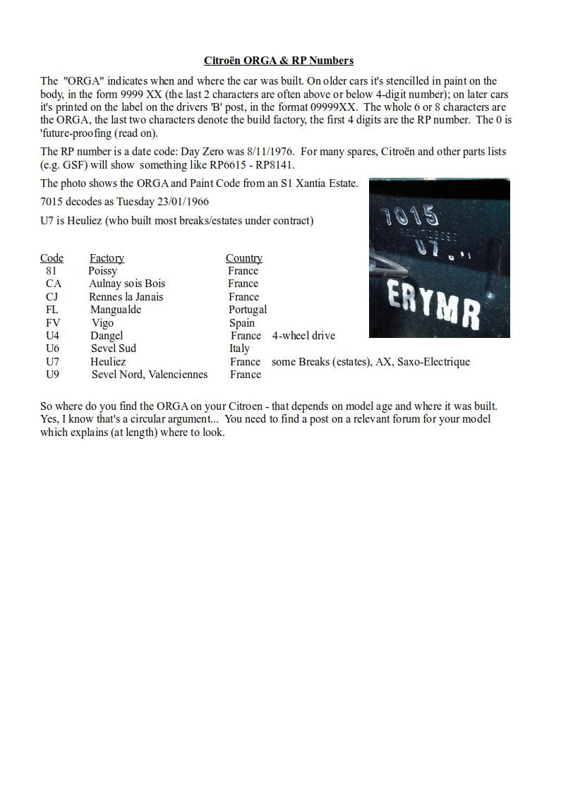

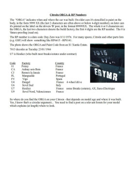

I've not been here since 2017 - but I now miss the magic carpet ride on long cross-country trips, so started thinking about another 'real' Citroen. An XM (Break?) might fit the bill and they're not (yet) fetching silly money so I joined the XM forum; where I've happened upon a post on this subject with a broken link to the relevant FCF Wiki. I can't find the Wiki section.
Anyway, I think I may have written or contributed to that Wiki, which was Xantia-specific, as I have a source file and a PDF. I'm out of date and out of touch, but for what it's worth here it is (edited to be non-specific):
Comments, Corrections and Additions welcomed please.
I also found a spreadsheet for doing the decode (type in complete ORGA or just RP number and it gives Factory and Build Date), but I now have nowhere to make it generally available (in .ods format).
