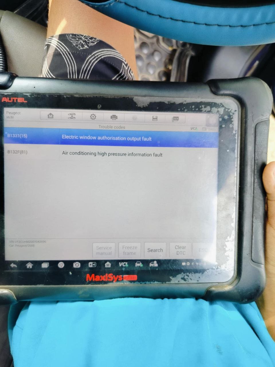

VIN _ VF3**************[VIN obfuscated, can be read by forum staff]
Error Code B132F (81)

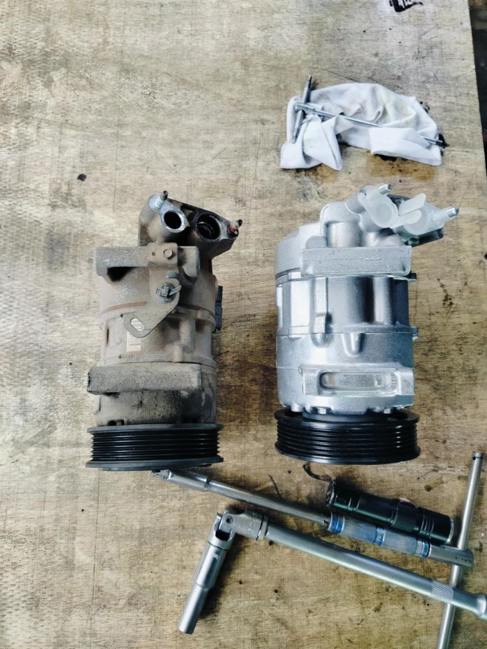

_Old compressor is working 30mins - 3 hrs while parking condition.
After that time, it becomes hot. Repair staff assumed that need to replace with new compressor.
_After replaced with new compressor, it is working around 15 mins.
_Error code is still happening.
_New gas (no issue)
_Clean condenser
What should I do for this issue?
Please suggest me.
Peugeot 2008 (2014) 1.2 AC is not working with this code B132F(81) Air conditioning high pressure information fault

From the information provided, there seem to be some possible causes.
Are the radiator fan(s) running correctly at both speeds?
Perhaps the system has been filled with too much refrigerant, was it filled by weight according to the specification? Does the pressure drop to a normal level if cold water is sprayed onto the condenser?
There could be incompressible gas in the system, Was the system properly evacuated before refrigerant was added?
It could be a faulty pressure sensor, was the pressure checked with an external gauge to verify the reading?

Re: Peugeot 2008 (2014) 1.2 AC is not working with this code B132F(81) Air conditioning high pressure information fault
What is the outside temperature, is it higher than usual ? Is this something that has recently started ?
