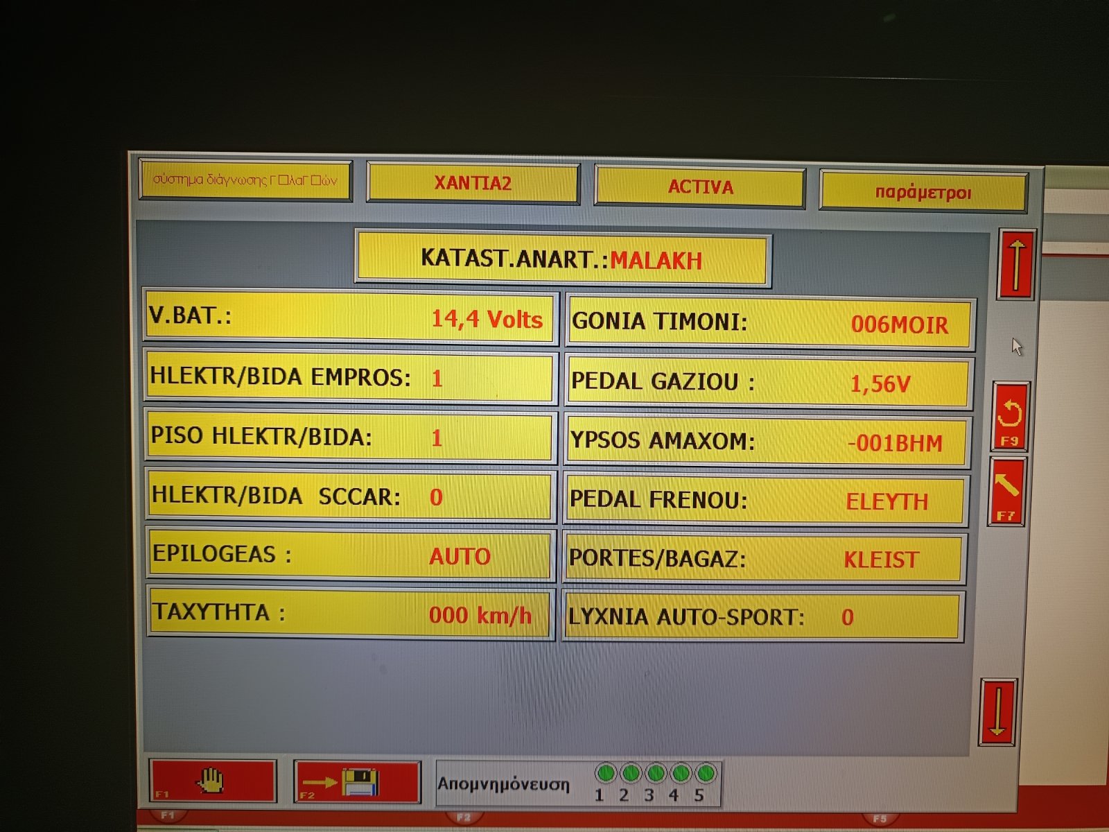

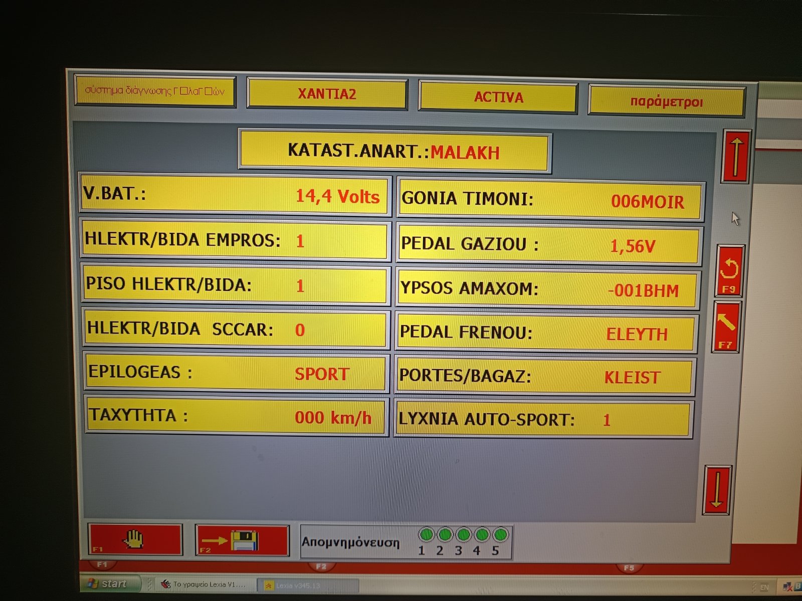

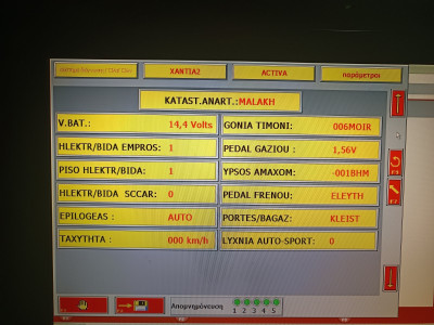

My 2T activa has a problem with the suspension. I used the lexia and have problem with the suspension setting. Whether I press it or not the electrovalves are in the same position sometimes stuck in firm mode other times stuck in soft mode . Thx anyone who can help . ( I add pics if it helps anyway)

Is this the common problem where the diodes fail?
Which can be fixed 'properly' by dismantling the valves and replacing internal components, or 'quicker' by slaving in one of these?
