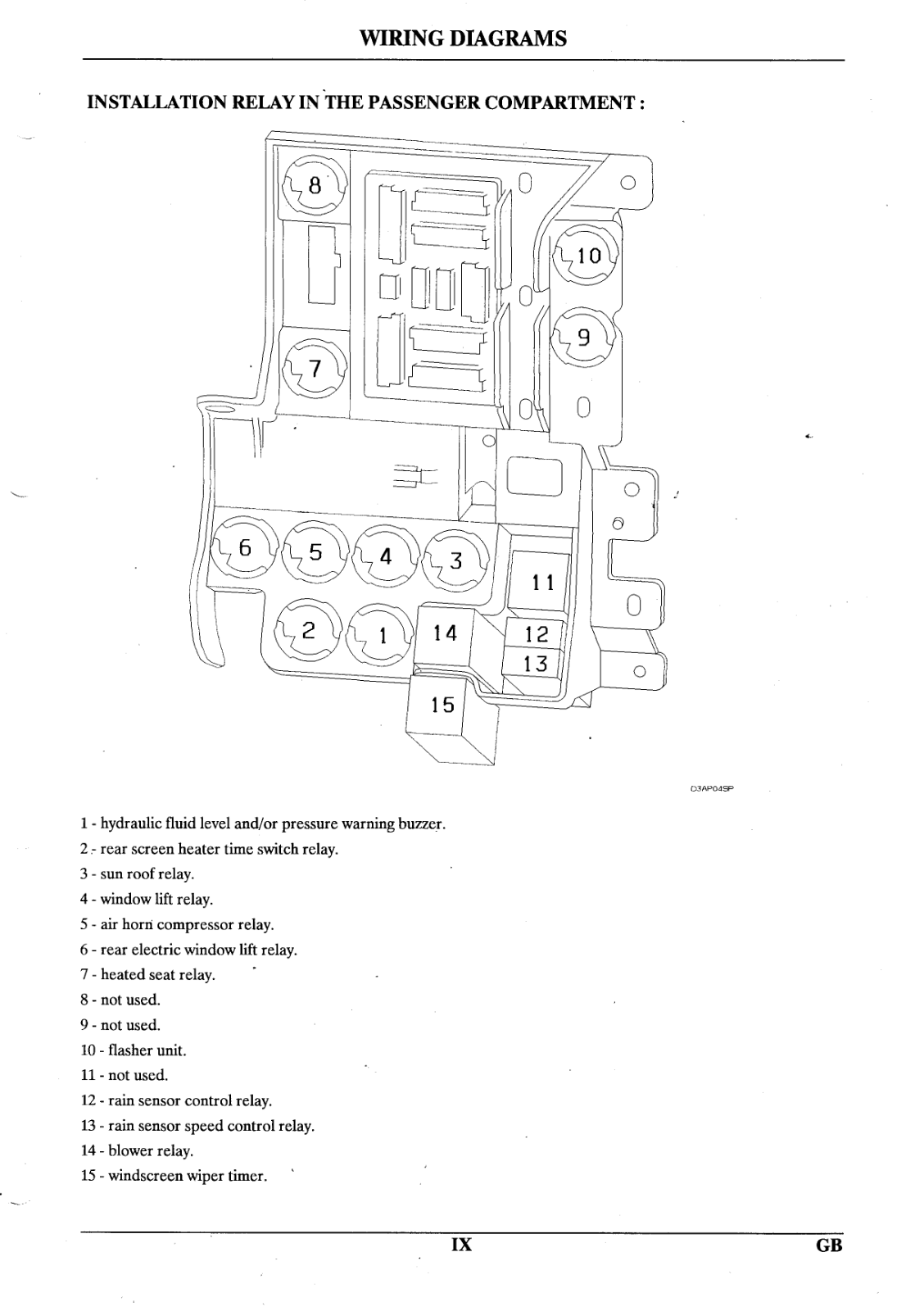

The wiring manuals indicate that at S2 introduction (RP7483 1998 model year) there was no relay fitted. At RP7668 there was a significant rework of the wiring and a relay (ref 8048) was fitted but it only controls the blower van. At RP8001 (1999 model year) there was another update and the heated rear window (and perhaps other things) were also fed from relay 8048.
if your car has relay 8048, it should be number 14 below the dashboard fuse board:
If your car does not have the factory-fitted relay, then this topic https://www.frenchcarforum.co.uk/forum/ ... 19&t=24786 (or the topics linked from it), may help you.
