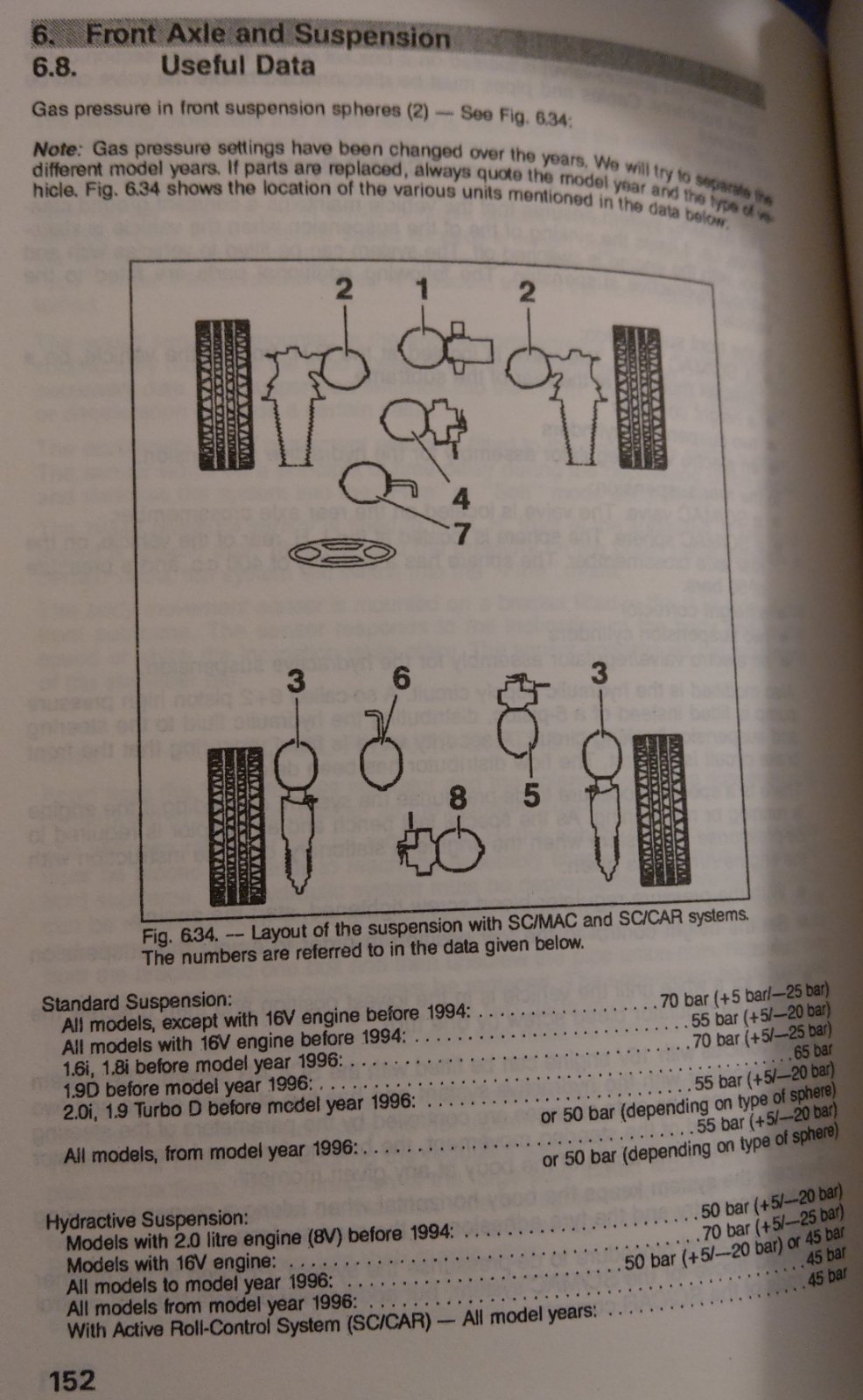

I've just dug my Activa out of a loooooong hibernation. Much longer then I realised it was to be honest.
Does anybody happen to have a sphere pressure chart for the spheres in the Activa?
If it makes any difference, my VIN is VF7**************[VIN obfuscated, can be read by forum staff].
I'd also like the specs of the front spheres on the V6 Activa as well as that VIN is for a 2.0 TCT Activa whereas mine grew an extra 2 cylinders ;)
Also, does anyone have a chart of which sphere is which on the car? On a normal Xantia I can manage OK but with the additional spheres on the Activa it would be handy to know which is which :)
The front of the car still feels quite soft but it'd be nice to pressure test all of the spheres and recharge any that aren't 100%.

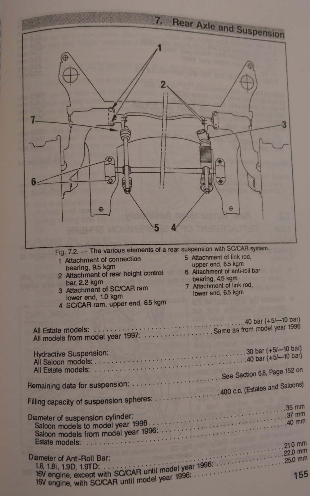

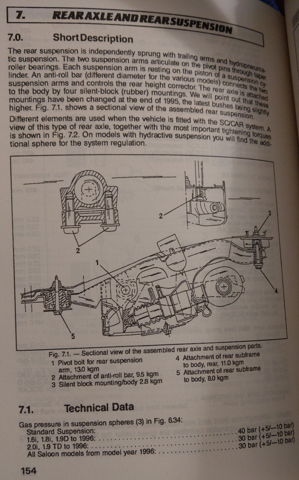

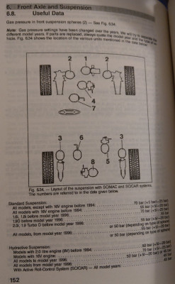

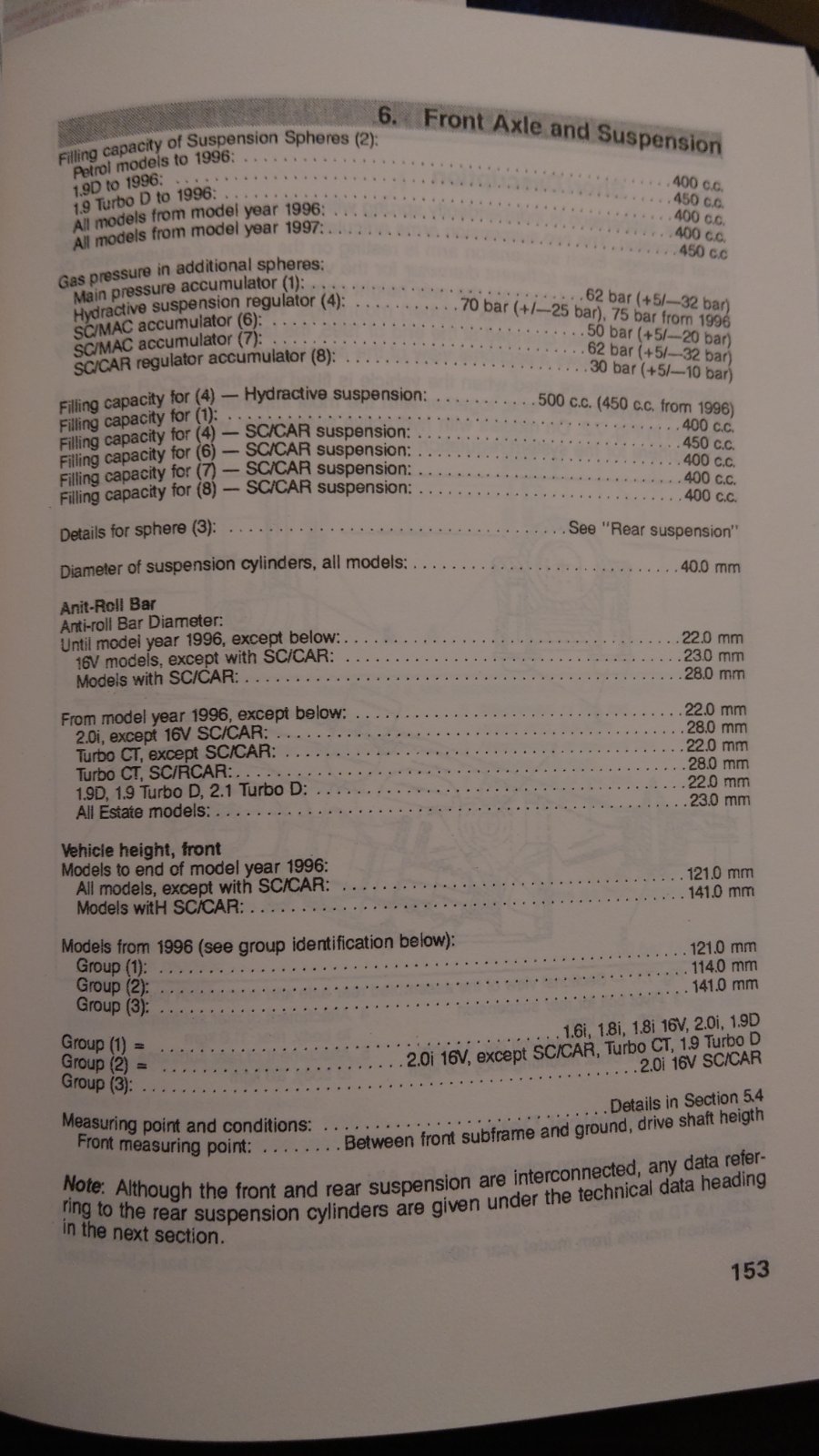

Russek gives the following info:
