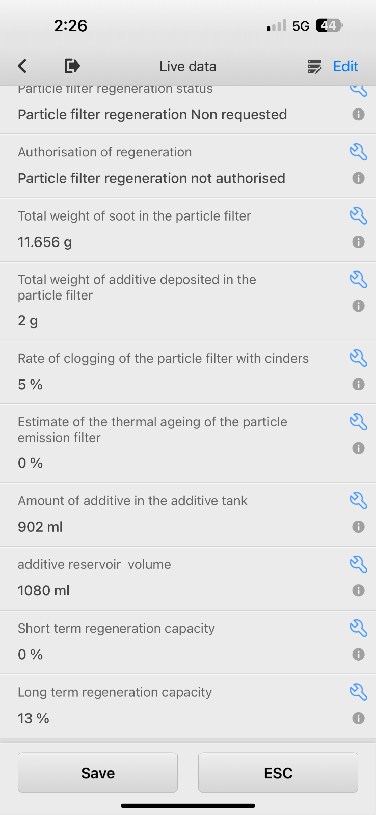

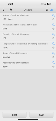

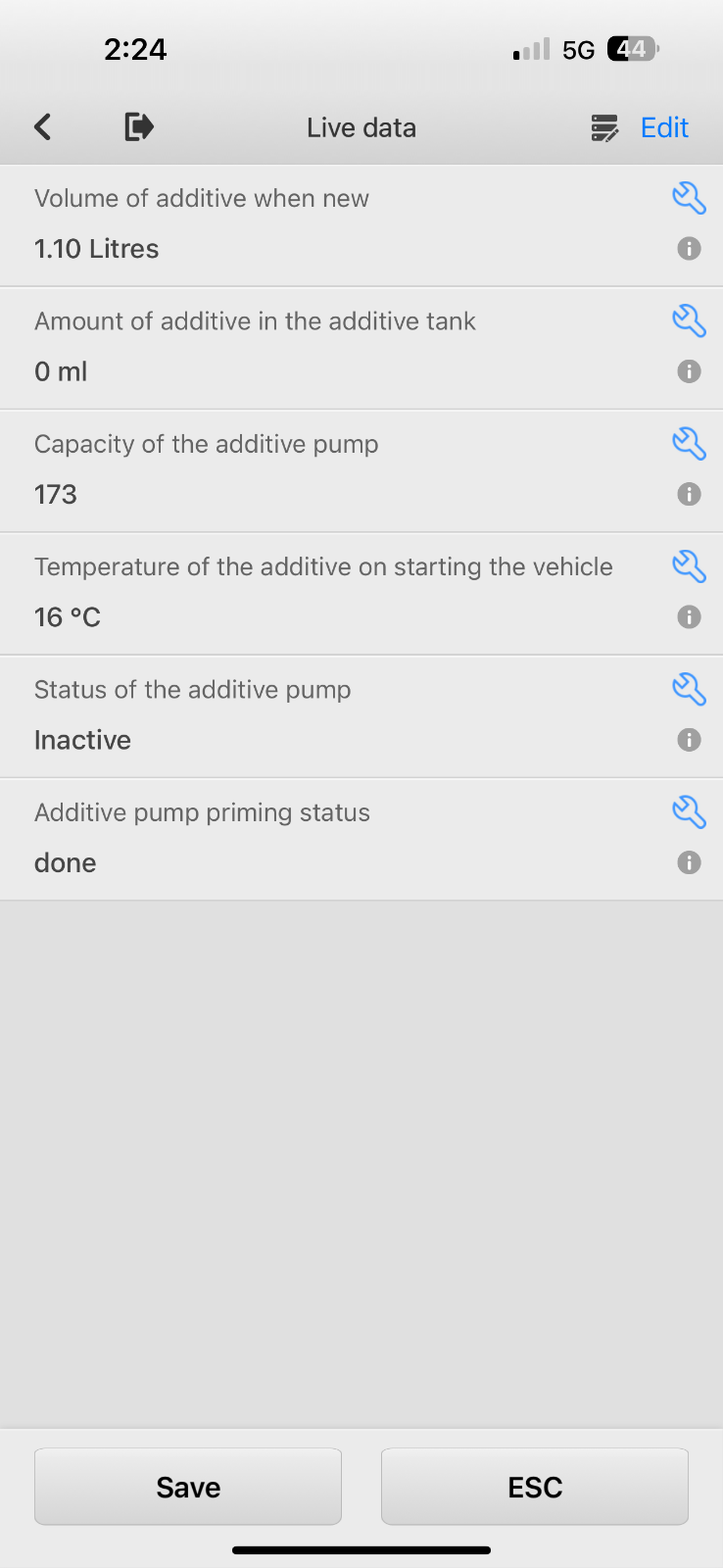

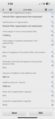

Long story short, I have a 308 T9 2015 (1.6 bHDI), which has had FAP refilled at around 30.000kms before. Today i noticed via an Autel MaxiAP2000 diag tool, that there are two different values shown regarding the remaining FAP content. One is 902ml (seems realistic), other one is 0.
No errors on the dash, and that number is decreasing which I assume it means that it gets injected into the fuel. Only one DTC was visible with the diag tool: FAP level low, which can be a remainder from old times, not sure.
My question would be: is it a problem? Maybe the dealership forgot to reset the counter on refill? Why does this information even stored in multiple places? Will this be an issue because it believes that it’s empty, and will not add FAP to fuel, or if that 902 number keeps decreasing I don’t have to worry about it?

Screenshots from the diag:

There are things that aren't clear because we don't know like what dealeship done. The values of eolys that is used seems right for the distance of 30k. If you use another diagnostic tool you may not have confused results like in Diagbox where there is only one field for remaining quantity.Usually eolys fluid lasts for many thousand km like in my car which has a 1.650 ml tank and when i fill it up i suppose for first time and just added one lt. of eolys in 140K km. Have in mind that the system just calculates with a start point of filling it up and resetting and then from filling the fuel tank every time and how much quantity of fuel.There is no physical measurement. In my opinion if you have your doubts and just to know where you are and , if you can yourself or if you can check in a garage, empty the eolys container, see how much is there, fill it up and reset it with a diagnostic tool that can do the job.

For sake of understanding, the continuation of the story: It finally happened, at the next diesel fillup, even though that the first number went from 902 to 898, SERVICE light came on, with the following errors:
B2EB0 - Additive Reservoir Empty
B1811 - diesel additive pump fault
There was about 7dl fluid remaining in the tank. Now it got refilled, and reset via proper diagnostics, hopefully this is all I had to do, and hopefully my EOLYS pump is still alive.
