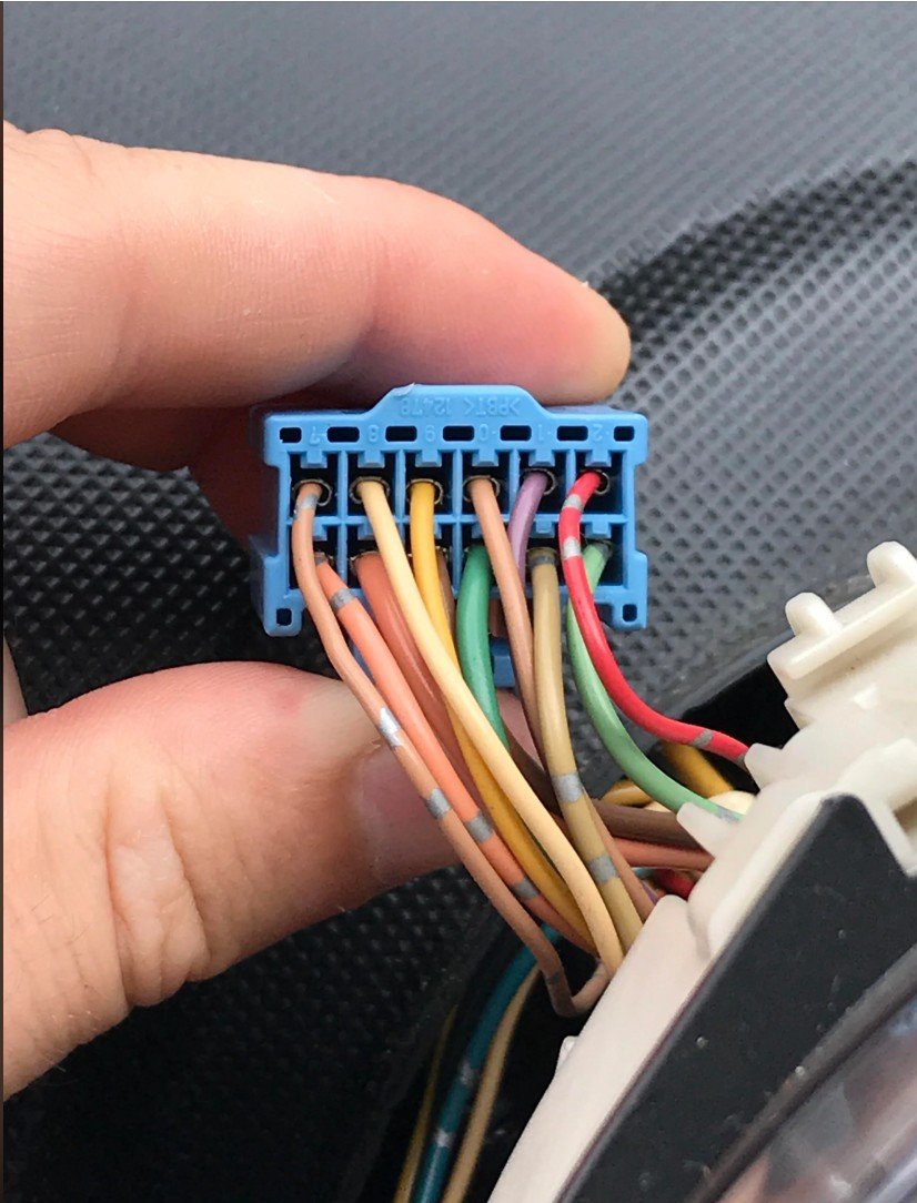

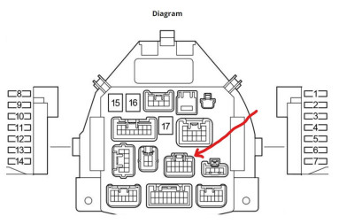

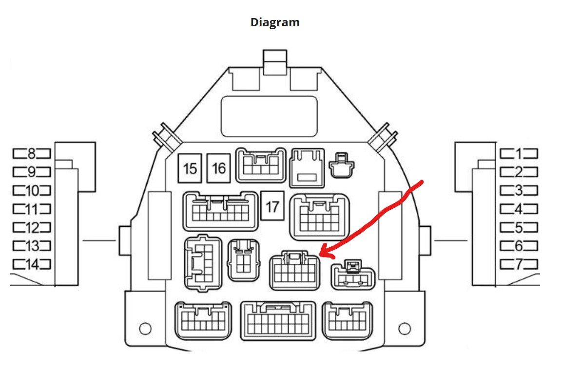

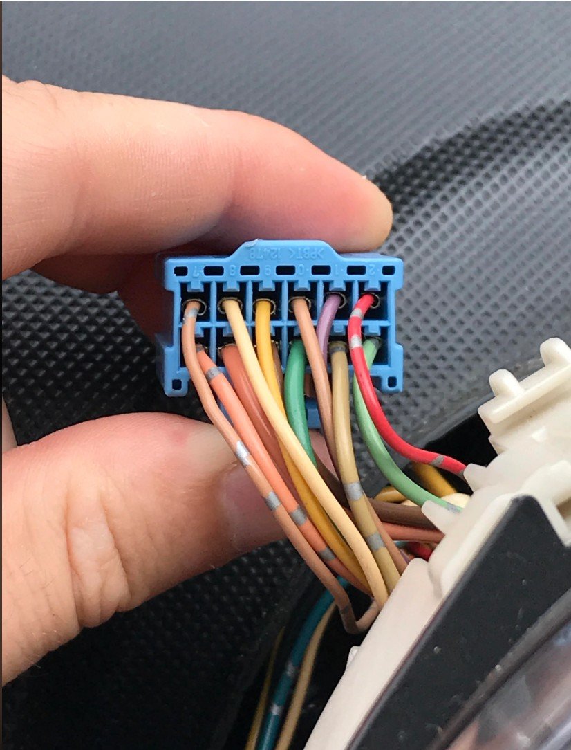

I ended up chasing the wiring, (blue 12 pin back of clocks) to indicator stalk connector. everything checked out. Re-fitted old clocks, found that indicators still do not work (they did before swapping) little fiddling and indicators came on, then off, then on. Just joking,
looks like I have 2 problems, 1st is an intermittent connection issue on the stalk, 2nd is potentially an smd led issue, with new clocks, relays trigger when indicators works, but theres no light on the leds. voltage flickers on board to signify that at leats something is getting thru.
Next check it to see if I can get to the boards led's and swap one out. if that doesnt work, ill need to check the relays to see if thay are latching or sending the correct votage to the led's
Failing that, its just send it back and find another clock on ebay.

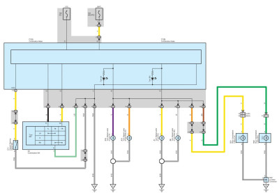

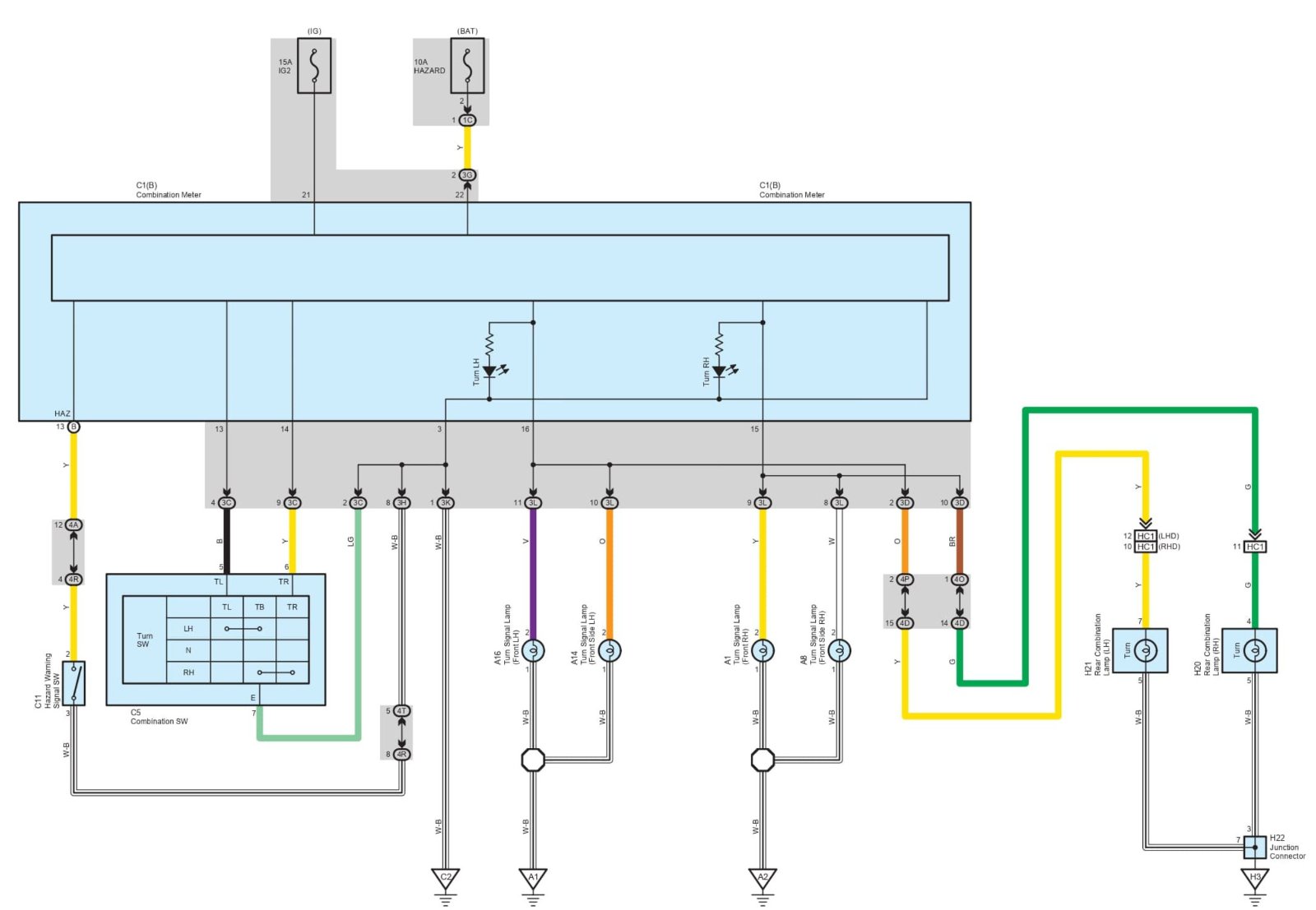

If anyones interested, ill post the wiring diagrams below
Cheers all:-).
