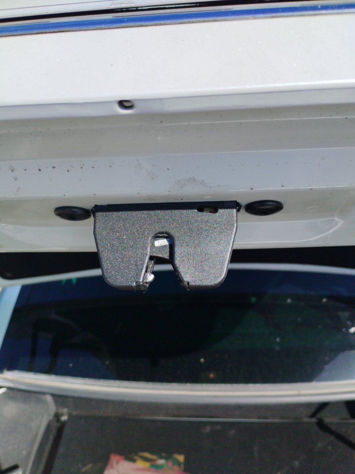

Re: Peugeot 207cc boot lid won't close after manual lift
When open, the latch should look like
I think that the U pin is:

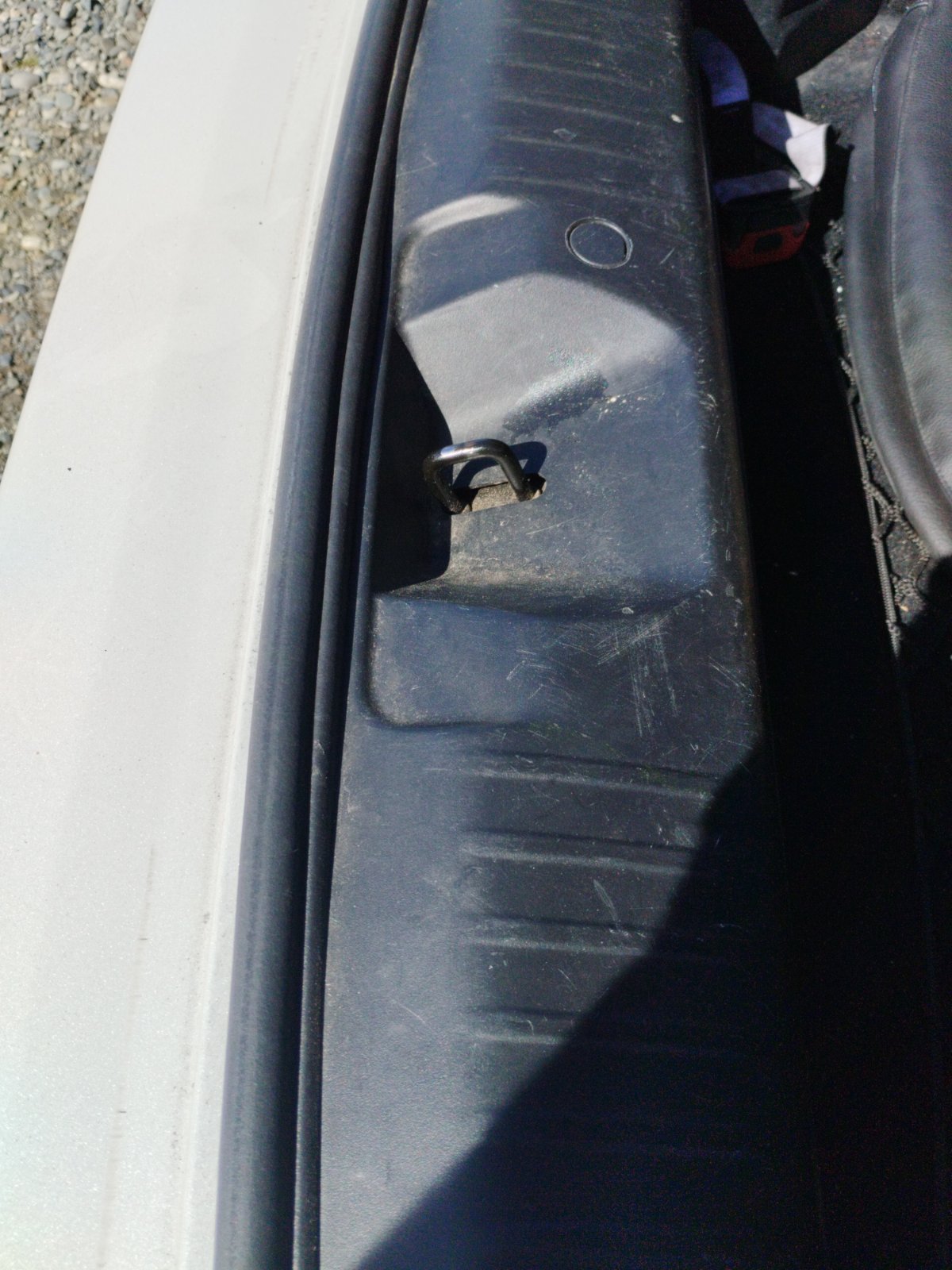

Hi, thank you but that's not the latch that's problematic. It's the lid ones. The upper boot cover, one on each side of the car with a hook
It's the hooks here but mine doesn't have the U bracket to turn
