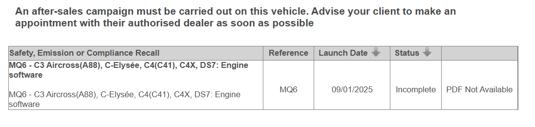

Morning, Marc. Bizarre - last week, two dealerships I checked with both confirmed my reg/VIN is due for a recall, which the leasing company originally communicated to me as the 3rd "voice" saying my car needs it. But today, one of the dealers says the GOV/DVLA records show my car does not need this recall for NOX or any other recall for that matter. I support I just go with what they now say.

Again, we need to be clear on the definition of a 'Recall'. It is not a 'Recall', it is an 'After-Sales Campaign.
It won't be on the DVSA list unless it's a serious safety issue.
It IS however listed on DS Automobiles own systems as relevant under your VIN. So you need to tell the bloke at the dealer who should know his job, to check on ServiceBox and he will see as clear as day it is required for your vehicle as below:
Click Image to Zoom
I get really fed up with these people not following their training.
Just to clarify further, if you look under the DS7 in the table I posted above, you will see that it covers models with your engine from production date:
29/3/2022 - 11/12/2023
Your DS7 has a build code (RPO) of 17004, which means a build or production date of 30th May 2023! So is within the vehicle range of affected vehicles. Don't be fobbed off, he has know idea what he's talking about.
