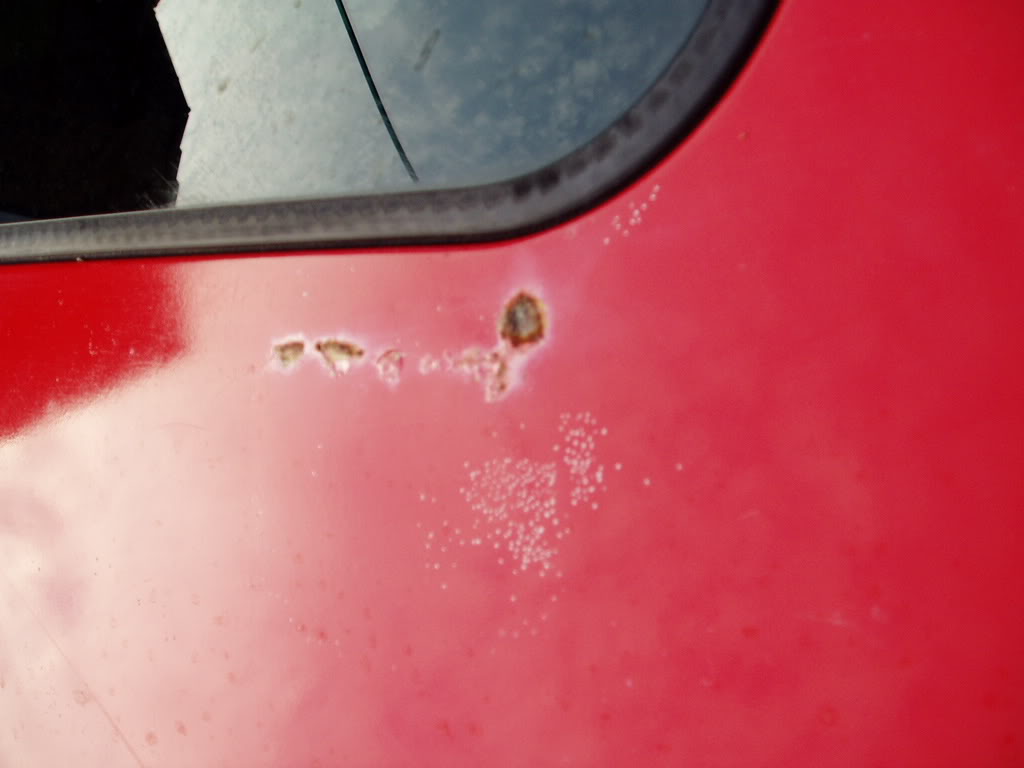

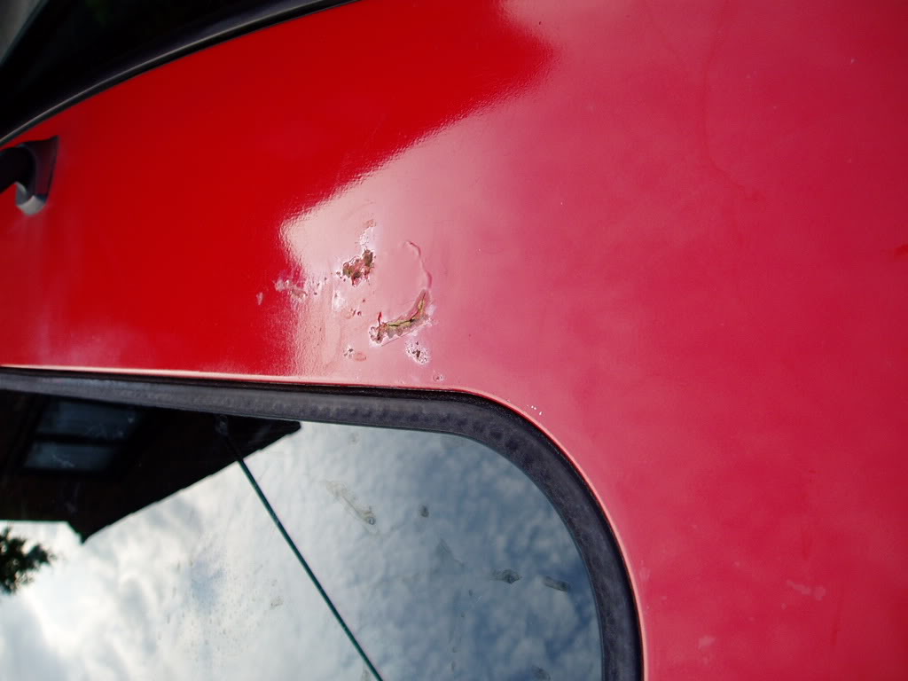

the XTDT im getting on saturday hasrust on the roof and i was thinking of cutting around the rust and getting a new piece of metal welded onto it
is this possible and roughly what sort of money am i looking at?
its in two different places, one at front of sunroof, the other at rear
Neither of those look bad enough to need cutting out, i would go with a small wire brush to remove the rust and surrounding paint, then you can assess it properly, steel expands to around 10 times its thickness before perforating the panels

I would agree with Mosser.. this is not that bad corrosion. I would say though that it would be worth using a power sander of some sort (either random orbital or a grinder with a sanding wheel in it) to not only remove the flakey rust, but also to smooth off any pitting, and get all the dusty corrosion out before using one of the "kure-rust" type liquids to it. If you are going to do it yourself, it needs to be a warm DRY day (low humidity) when you do the repainting, otherwise the rust will come back. Best time to be doing this is in a heated garage, on a dry day in winter (for ultra-low humidity). Oh, and lots of t-cut once you've painted it.

"pitting" is an effect of corrosion, whereby the surface is no longer smooth, and has generated a large amount of small craters, or "pits" hence pitting. Looking closely at those pictures I would say that all the original corrosion was not removed the first time (some still remaining at the bottom of the pitting)
I would not use a dremmel or anything that small to do this job.. it needs a large surface sander in order to achieve a smooth finish. A random orbital sander will have that effect, but will probably take a fair time to completely remove all the oxide.
Filler... not needed. High-build primer is all that is needed, with a good rub down with wetted 1000 grit paper between layers. make sure every layer is well blended with the surrounding paintwork, but don't go too mad, or you'll remove too much of the original paint.

That first picky looks like body filler to me and that red paint is very orange peelly . It looks like a split in the roof. In which case be careful you ain't buying a lemon that's had a front ender. The roof could have been all smacked up and as aquick repair some old filler was used to sucker some one in to buying. Not having a go, it's just unusual for rust to come up around the sunroof especially as its not really on the seals. Get an HPI befor handing over your money could save you some work.

yeah i was told the rood rusted and an attempted repair by an ameteur was done. now its back again
