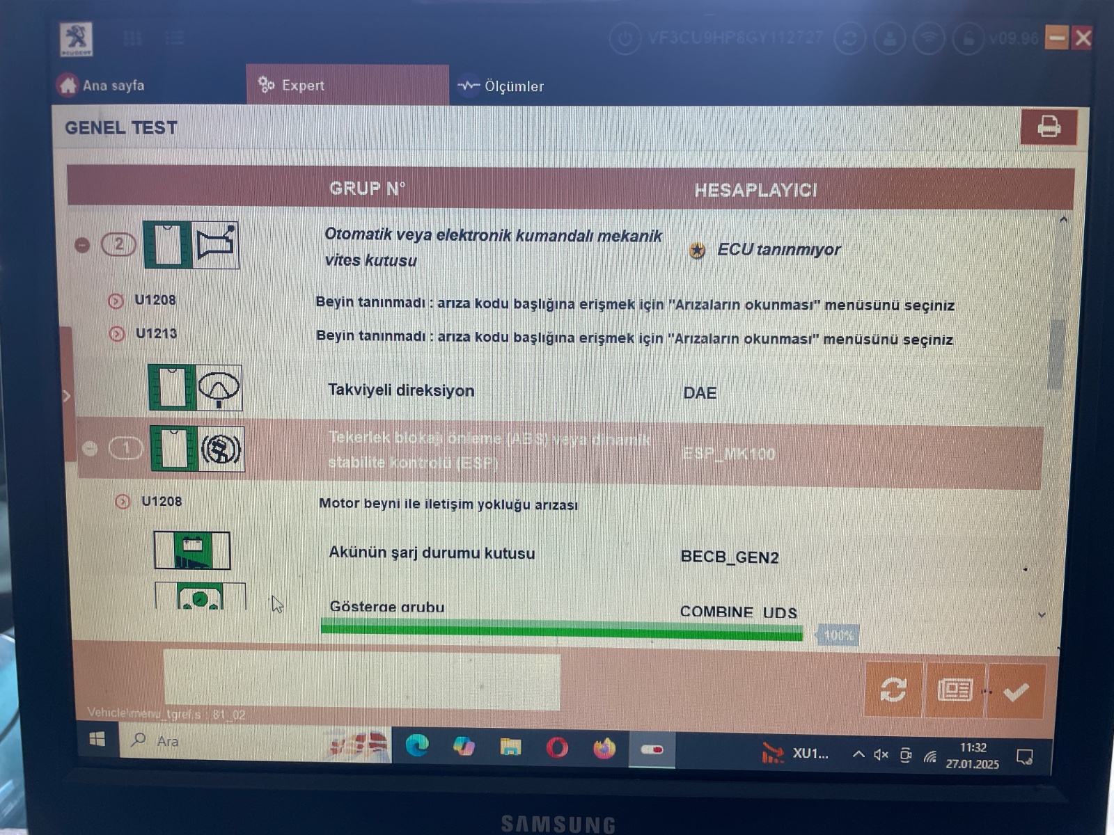

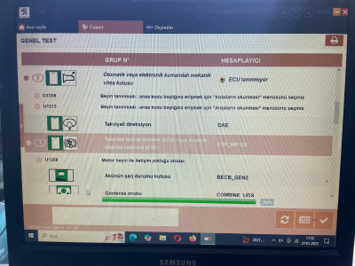

At the service, the Peugeot PC was connected, and based on the error codes, we changed the EFG battery to AMG. The crankshaft position sensor and its connector were also replaced due to potential contact issues. The issue was not resolved.

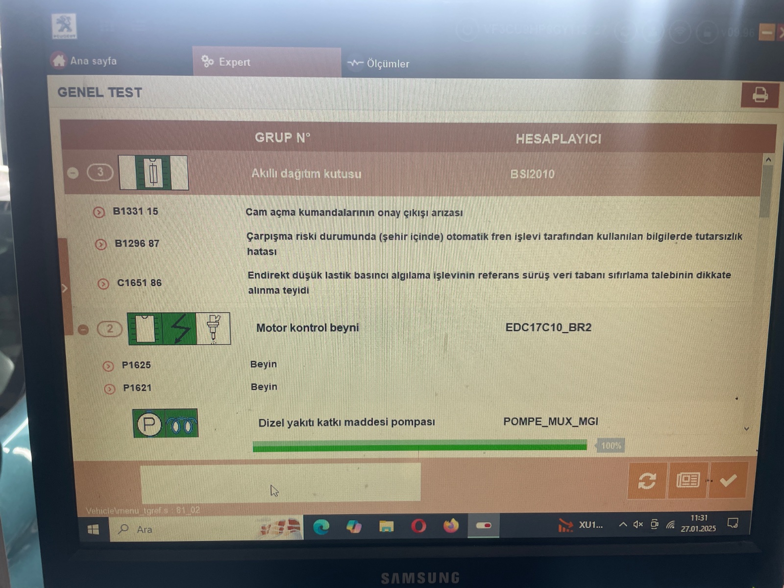

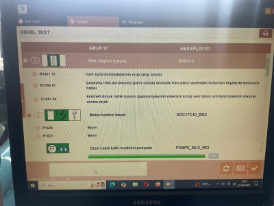

DTC Codes:
ECU: P1625 - P1621
Gearbox: U1208 - U1213
ABS/ESP: U1208

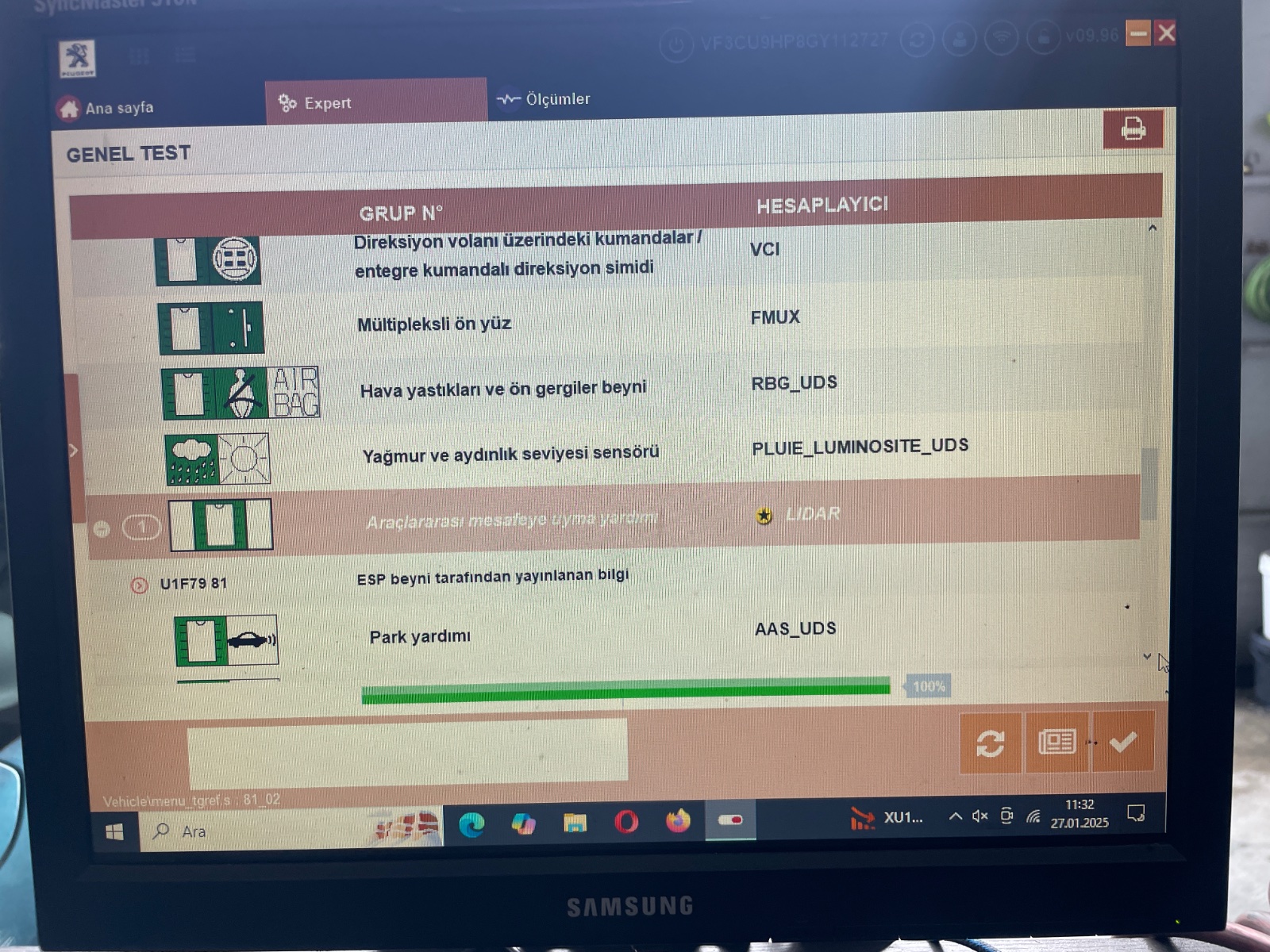

LIDAR: U1F79 81
Since the car also displayed an automatic braking system error, I suspected there might be an issue with the Active City Brake sensor, so I disabled the Active City Brake feature in the settings. The issue still wasn't fixed.

Re: Peugeot 2008 - P1625 & P1621 (Intermittent)
First all the following you list:
- Automatic Emergency Braking System Fault
- Engine Fault
- ESP/ASR System Fault
- Reverse Assistance System Fault
... will be as a consequence of a fault with the ESP system as all these functions rely on that to work correctly, including the electronic parking brake in automatic mode.
You have a lot going on here, but here are some of the faults:
C1651 86 Tyre under-inflation detection reset request signal fault: Absence of response from the ESP ECU (again this can be because of the ESP fault as above)
B1331 15 Electric windows authorisation fault: Short circuit to positive or open circuit (separate issue).
Fault Code: P1625
Description of Fault:
  • Computer: Software redundancy fault; Calculation error detected. Fault inside the engine ECU detected.
Conditions for Fault to clear:
  • Manual clearing of the fault then starting of the engine
Downgrade Modes whilst Fault is active:
  • Engine stopped
  • Switching on of the warning lamp and/or warning message Warning lamp STOP
Symptoms:
  • Jerking/stalling
  • Starting problem
  • Lack of power
Suspect Areas:
  • Engine ECU
Fault Code: P1621
  • Computer: Software redundancy fault at the injection (Level 2). Malfunction internal to the engine ECU on the torque calculation functions.
  • Switching on of the warning lamp and/or warning message "SERVICE" warning lamp
Symptoms:
  • Jerking/stalling
  • Starting problem
  • Lack of power
  • Absence of automatic stopping of the internal combustion engine (Vehicle equipped with "stop and start")
  • Problem with automatic restarting of the internal combustion engine (Vehicle equipped with "stop and start")
Suspect Areas:
  • Engine ECU
Fault Code: U1213
  • Fault with the information sent by either the ABS/ESP ECU or the electric parking brake ECU : Value received incorrect. Absence, or wrong value, for the CAN information containing the electric handbrake status, the torque requested by the ESP ECU, or the rear wheel speeds.
    Context of appearance of the fault code:
  • Ignition on
  • Technical precision on the context of appearance of the fault code Supply voltage correct
  • Absence of fault codes U1000 - U1003 - U1113
  • The system is not in starting phase
  • Reception of 20 consecutive items of valid information
  • Possibility 1
    Electric parking brake: Invalid signal
    - Engine running or in Stop and Start phase ; Replacement value : Brake activated
    - Engine stopped and not in Stop and Start phase ; Replacement value : Brake deactivated
    - Crawling deactivated
    Possibility 2
    - Signal for the torque requested by the ESP ECU : Prohibited value
    - Replacement value : 0
    Possibility 3
    Signal for the rear RH/rear LH wheel speeds : Invalid signal
    - Calculation of the replacement value from the vehicle speed
Symptoms:
  • Difficult/impossible to change a gear
  • Lack of power
Suspect Areas:
  • 28-way harness of the piloted manual gearbox ECU
  • ABS/ESP ECU
  • Electric parking brake
  • Controlled manual gearbox ECU
