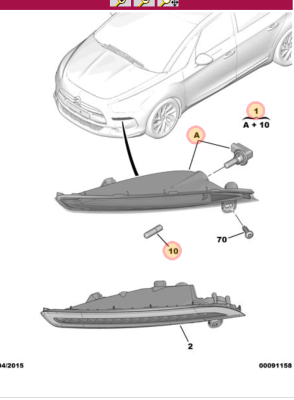

Got something like this?
x 6950
Re: DS5 front turn indicator not working
heiluri wrote: 20 Feb 2025, 15:32 Hey all,
My DS5's front left turn indicator stopped working, seems to have a lot of moisture inside. Funny thing is, when it's cold outside, below freezing point the indicator suddenly works :D
To dry it, I tried to pop it out pulling out the small black lid in the corner below the indicator to unscrew the torx screw. But once the screw is removed I am still unable to take out the indicator assembly and cannot figure what else has to be done. Any help from you guys? If the VIN is needed, it's VF7**************[VIN obfuscated, can be read by forum staff]
Thanks for any help!

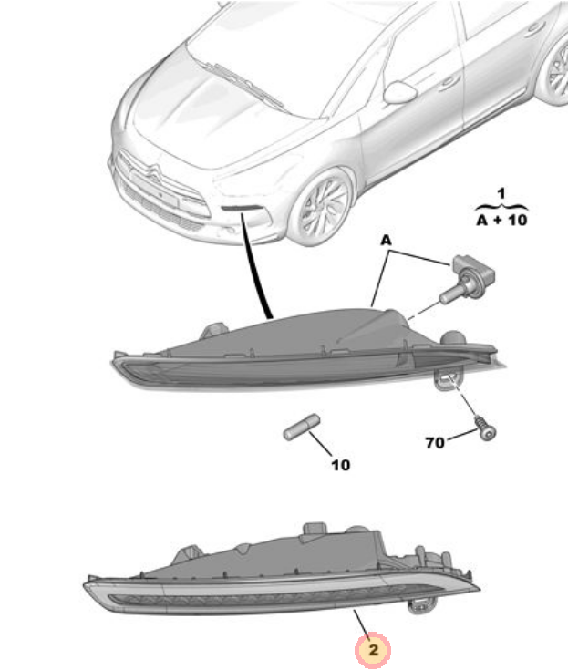

The unit is replaceable, but you'll likely have to swing it out, which may require access from underneath / or from the wheel arch once the lining is removed in order to detach the connectors.
Not cheap though!
Front Left LED Unit, part: 9808732180, £485.36
Front Right LED Unit, part: 9808732080, £485.36

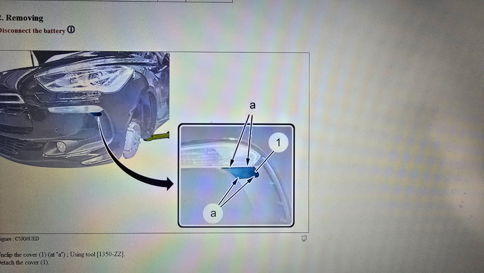

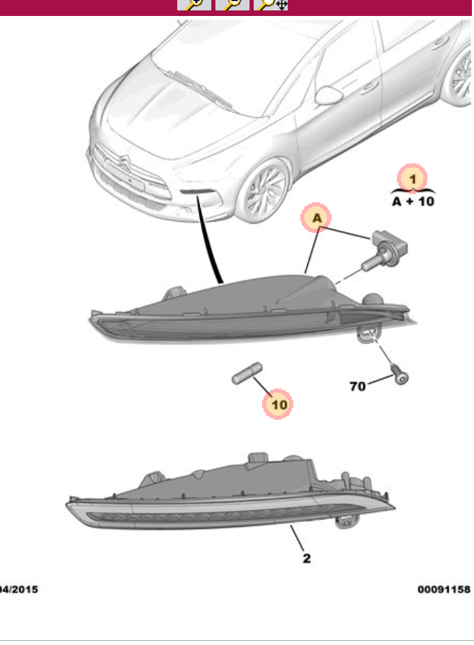

@Djandree
I think the downloadable servicebox is outdated for my DS5 which is from 2016.
But what a pain in the a** that indicator!! We were 2 guys trying to remove it but after removing the torx in the bottom corner and pushing the clip in the engine compartment the thing is still like it's bolted to something :cry:

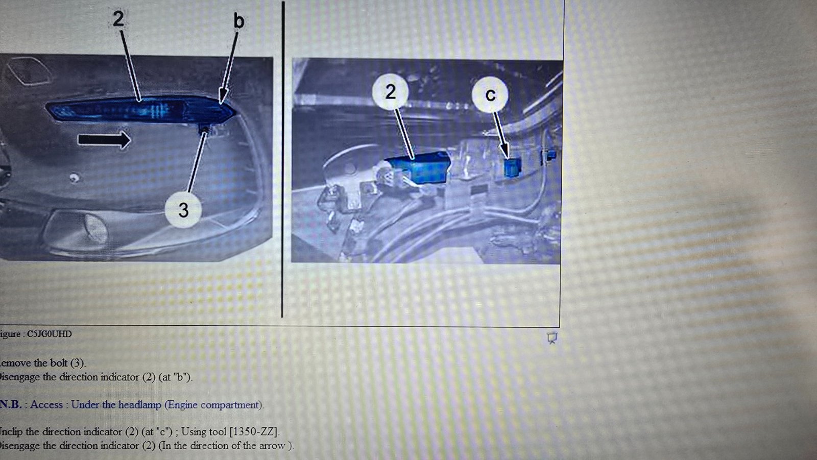

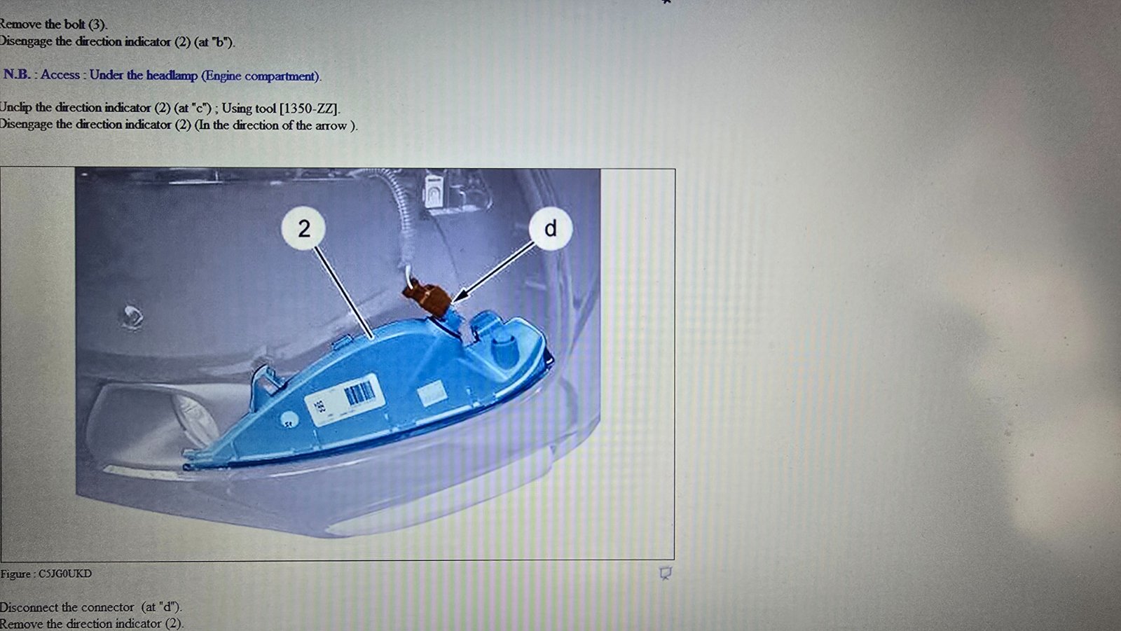

Ok, the indicators are out. Yes, both of them. Those disassembly pictures are partly wrong. I loaned a gooseneck camera to see in the engine compartment and there is 2 additional screws that have to be removed in order to take the indicator out.
Took the problematic one out first, it was full of water. Just for the fun of it we took out the other too and surprise surprise, it also has taken water in it, still working though.

Correction to previous post. Only one screw needs to be removed in the engine compartment, not two as I said. This is for the "scrolling" led indicators which I have.
I dried the indicators with an electric childrens shoe dryer. I put the indicators and hoses from the dryer into a box and timer on 4 hours. Now they're dry as a nun's sexlife :-D One indicator is still working but the other is completely dead.
