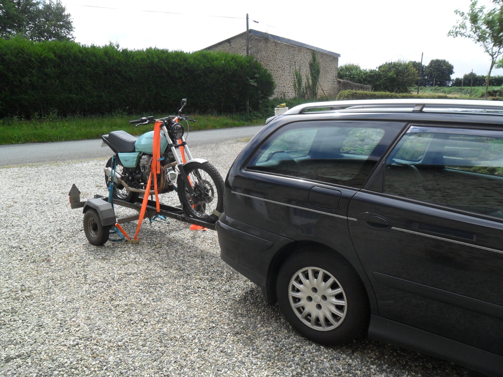

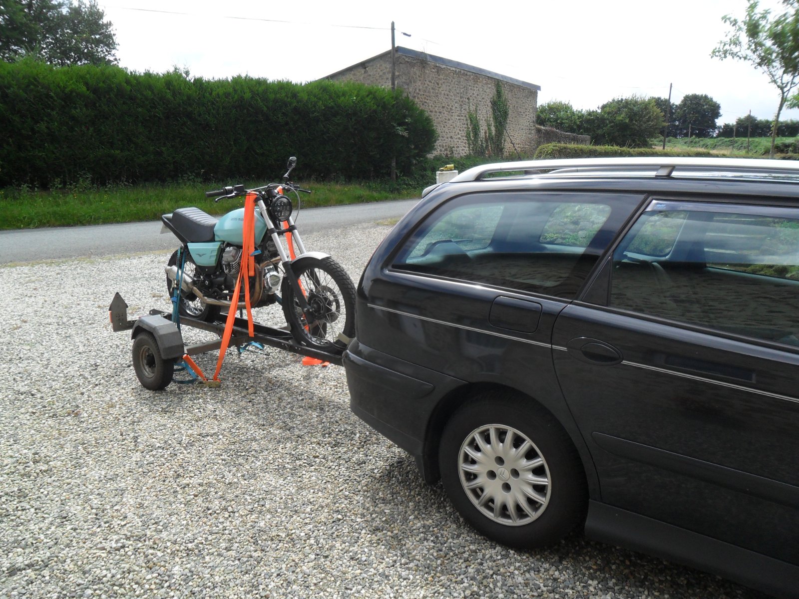

I'm not too worried about trailer sway tbh, it'll only be pulling a small motorbike trailer anyway, but I've towed a lot of stuff of all sizes over the years ( HGV class 1 ). I'll cope :)

2cvandy wrote: 20 Feb 2025, 14:14 ....... I'm not too worried about trailer sway tbh, it'll only be pulling a small motorbike trailer anyway, but I've towed a lot of stuff of all sizes over the years ( HGV class 1 ). I'll cope :)
It's up to you of course, but I have experienced trailer sway, ½ ton of sand behind Xantia, and it was not fun!
  • The bike on your trailer has a high center of gravity therefore may be more prone.
  • I assume the trailer has been designed to be 'balanced' when loaded, I suggest a box with a bag of sand at the trailer front to give a better, nearer the required nose weight. The Citroën suspension tends to try to always push up when loaded, hence the higher nose weight.
