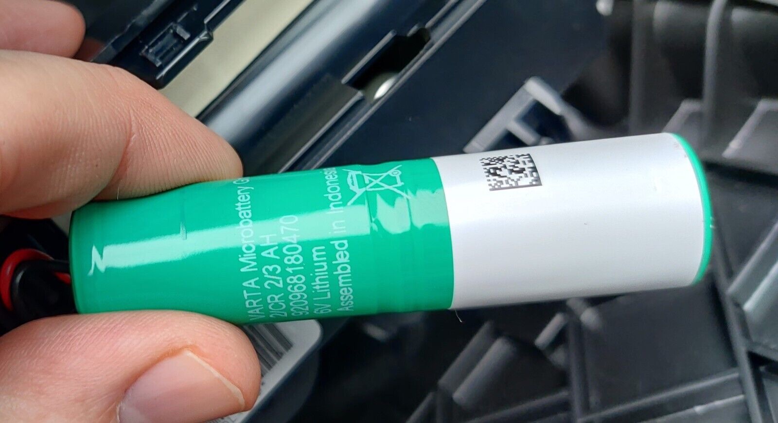

Re: NG4 time and date setting
It’s a 6v lithium like this:
- Posts: 9434
- x 1943
Maybe 2 3v batteries in series. It can't be that difficult.
