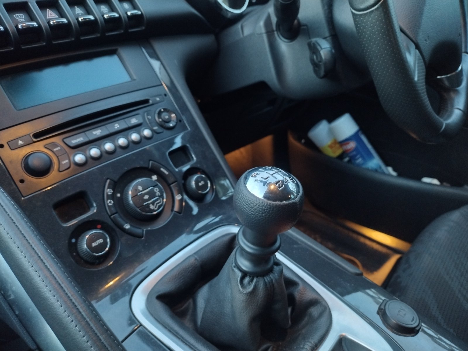

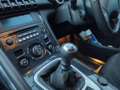

Plasti-chrome is flaking on the old one, and I cut my finger on it the other day. New Chinesium procured, but I can't shift the old one. 6 speed so supposed to just pull off, but not by me!
Slide hammer? Heat it up? Long pry bar or cold chisel under the edge and a medium hammer to try and persuade it off? Perhaps I can make a tool to clamp behind it so I can bump it rather than just a straight pull.
Don't really want to wreck it in case the new one doesn't fit, but that might be the ultimate solution...

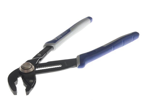

I used part of an old towel around the knob on my 307 to protect it for precisely the same reason as you - the new one didn't look like it was going to fit! But I put a pair of multigrips around the towel and jigged the old knob back and forth until it came loose enough to pull off.
(This editor doesn't seem to know what multigrips are - it shows me a spelling error. I thought it was a common name, but not according to the editor. In case it isn't understood, here's an image.
