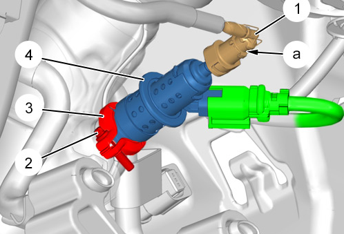

I don't have the specific info for this vehicle as it will be one of the last production models that was fitted with this system, but unlike later vehicles where the injector is easy to get to from the top of the engine, this design requires access from underneath near the catalyst. I don't know what you think you can achieve by trying to dismantle anything before taking it to the garage as you really need it on a hoist to start with and you can't really dismantle anything and then drive it to the garage.....
The Heated Urea Pipe has to be unclipped at 'a'
The power connector in green to be removed
Then it needs to be unbolted at (2)
But it's not practical or advisable to leave all this hanging about then driving.....
I suggest if you are just having the urea injector replaced that you get another quote from another garage as that seems excessive for a simple injector replacement. Can't be more than a 10 minute job once on a hoist to swap them out.

thanks GiveMeABreak for the quick and detailed answer!. You are right: luckily here in Germany (not sure if that is that easy anywhere else) there is a few "open" workshops where one can rent the time for hours (around 10 Euros/hr.) and have access to a car lift and even to specialized tools. Looking to the picture it seems that once that the clamp (2) is removed, it should not very complicated to reach the power connector and the hose clip once the injector is partially "hanging", or?.
