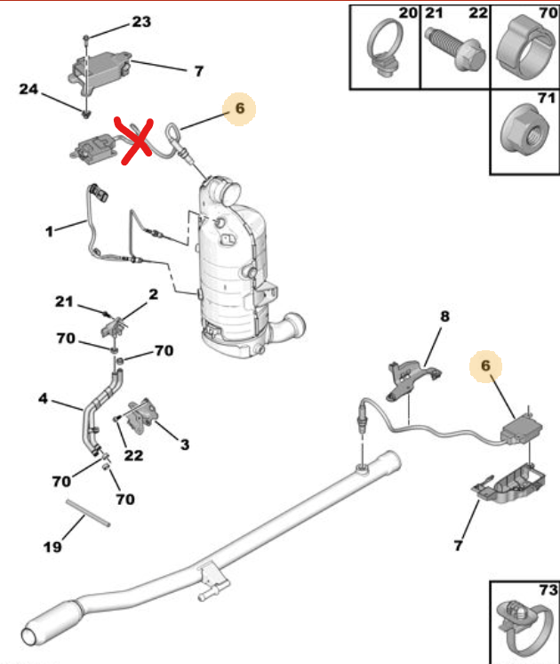

the autel diag system found the "pre cat" nox sensor wasnt giving any readings... but the after dpf nox sensor was...
we have searched high & low on the web & car for this pre cat nox sensor... anyone know where it is at all?
thanks in advance

Doesn't have one, the upstream figure is fictious.
x 6956
Re: emissions failure
It's generally only the Euro 6.2 systems that have an upstream and downstream NOx sensor. Prior to this it only has the one.
On my Aircross I have 2 shown at (6), but you won't hve the one I have put a red cross through on your vehicle.
