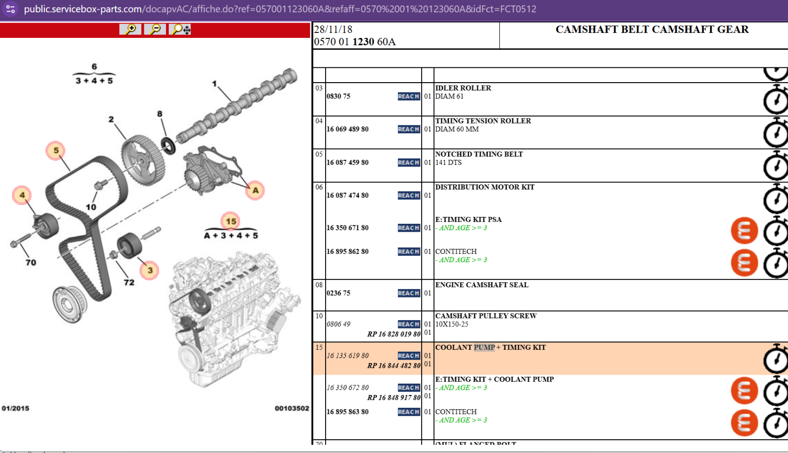

Yes, that's listed as DV6C. There are lots of different kits for these engines, so best to cross reference against the OE number:
1684448280 - £257.62 Earlier part number was 1613561980 and might be cross referenced elsewhere. You are supposed to fit a new crank pulley bolt, not included in the Cit kit, but should be if you buy a decent non dealer one (was in the SKF kit I used on my 3008 last year). Sorry, no idea what size the crank seal is!
Note if this is on its original belt it's very much on borrowed time and you need to change it ASAP!! They like to shed teeth...
Seems to cross reference to SKF VKMC03316 - https://vehicleaftermarket.skf.com/uk/e ... /VKMC03316 this is the 25mm version, rather than the later 19mm which are shorter lived!
