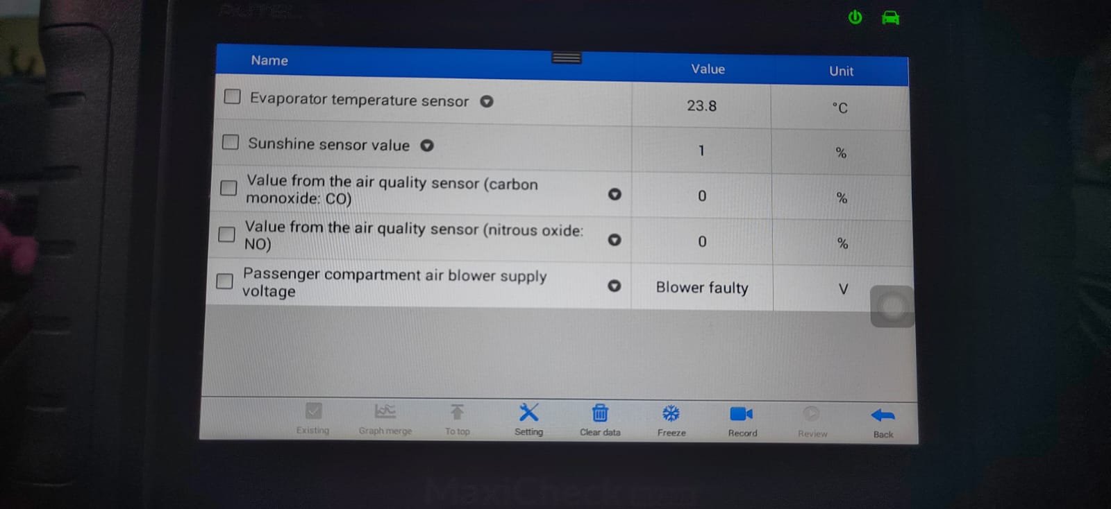

Having performed a BSI reset I now get a permanent fault code B1310 01 Passenger compartment air blower repeat signal fault. I suspect the AC blower control module to be at fault, however there are a number of things I find strange;
1. If I set the interior blower to windscreen de-mist and clear the code the aircon comes back to life and blows ice cold right up to the point the de-mist function is turned off and air flow is diverted back to the normal vents.
2. Looking at live data (image attached) the “passenger compartment air blower supply voltage jumps between “5V” and “Blower faulty”. However, measuring the voltage directly on the blower indicates that the blower receives anywhere between 6V & 12v depending on the fan speed selected on the car’s climate control panel. So the questing is what reports the blower voltage back to the ECU, I would assume the blower control module?
3. The blower was removed and bench tested, all checked out. No sparking, the bearings spin freely and the blower motor all round performs as expected.
4. The wiring from the AC control module to the AC ECU as well as the respective earthing points were checked and confirmed to be in order.
In closing is there a way in which I can confirm the AC control module to be at fault, i.e known resistance values across the 5 pins I can measure?
Thanks,
Thanks,
Justin_Brown
- Posts: 18
- Joined: 08 Nov 2017, 16:34
- x 4
Re: DS5 2.0hdi intermittent aircon
Update;Justin_Brown wrote: 01 Mar 2025, 20:23Having performed a BSI reset I now get a permanent fault code B1310 01 Passenger compartment air blower repeat signal fault. I suspect the AC blower control module to be at fault, however there are a number of things I find strange;
Thanks,
Pins 1 & 2 of the blower control module are signal feeds to/from the AC ECU.
The blower motor control module was removed and there appeared to be some or other film over pin 1 which was subsequently sanded off. The control module was then re-installed and the corresponding fault code cleared.
By the looks of it pin 1 of the control module carries a reference voltage back to the AC ECU measuring between 1v to 5v. This signal voltage is proportional to the fan blower speed.
To confirm the connections pin 1 was back-probed while live data of the AC ECU was being read. The reference voltage read by the ECU corresponded to that of the back-probed reading meaning the ECU was reading and interpreting the signal correctly.
In conclusion the AC compressor has come back to life and is operating as expected and no permanent/intermittent fault code has returned.

You didn't mention anything about the interior fan in your original post, only the compressor clutch.
Was the interior fan still working while the AC was not?
Scan tool did not reported a fan controller fault? Despite the AC ECU detecting a fault and shutting down the AC?
But good catch anyway.
