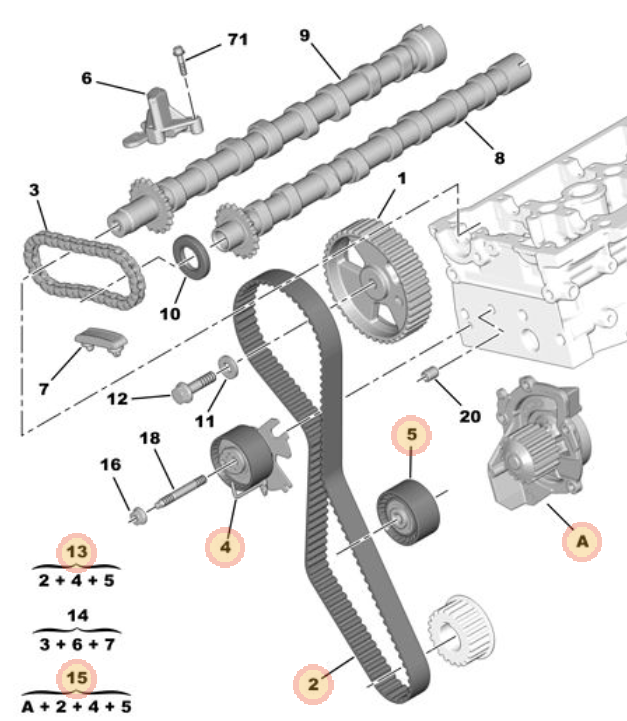

Ok, so a few choices:
(2) OEM Original Timing Belt, part: 0816K8, £152.90
Cheaper PSA Timing Belt, part: 1633127280, £68.82
(13) OEM Distribution Motor Kit, part: 0831W1, £210.60
Cheaper PSA Distribution Kit, part: 1614346980, £146.35
(15) OEM Distribution Kit plus Water Pump, part: 1613561780, £300.77
PSA Cheaper Distribution Kit, plus Water Pump, part: 1638073480, £155.96
