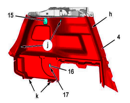

Not easy, because you have the Hybrid, so everything is locked down tight and will require removing the rear door sill trim before you can access the Rear Wing Trim:

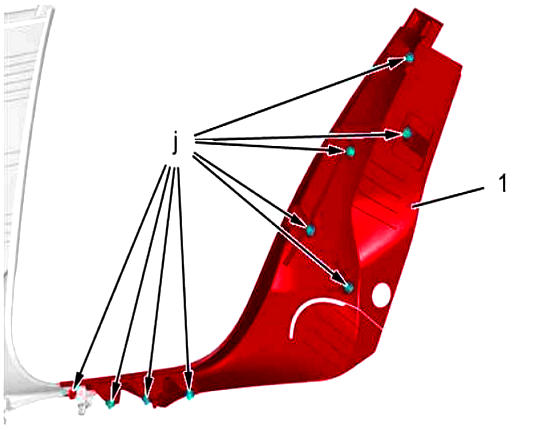

Rear Sill Trim Remove:
The rear shelf trim
The rear seats
Unclip the hinged rear door sill trim (1) (at "j") using trim removal tools.
Remove the hinged rear door sill trim (1).

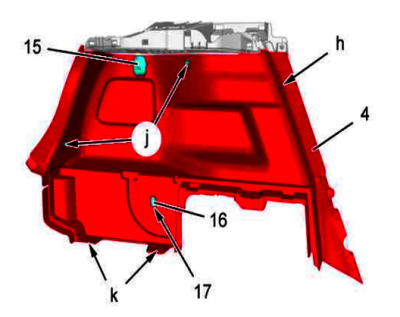

Rear Wing Trim Remove: The rear door sill trim (see above).
Detach the fixing (15) (A quarter turn) (Anti-clockwise).
Unclip and remove : Using the tool [1350-ZZ] :
The clips (at "j")
The blank (16)
Remove the bolt (17).
Disengage the rear wing trim (4) (at "h" and "k").
Remove the rear wing trim (4).
The rear shelf trim
The rear seats
The clips (at "j")
The blank (16)
