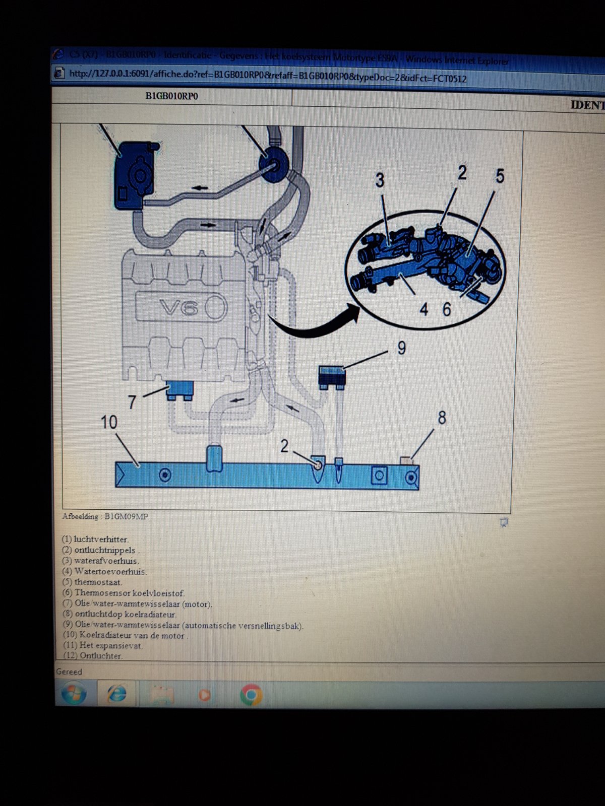

Re: C5 X7 3.0 V6 Coolant Change - Bleeding?
There are 2 of them, one on the thermostatic house, and one behind the motor in the heating tube.
Just open them and fill the reservoir without running the engine.
Wait until the bleed screw on the thermostatic house spill, the close this one and the same on the heating tube.
You have to look for #2
I think the information that Kees posted is for the petrol 3.0 V6, rather than the HDi 3.0 V6 and I suspect that's the reason for the difference.
