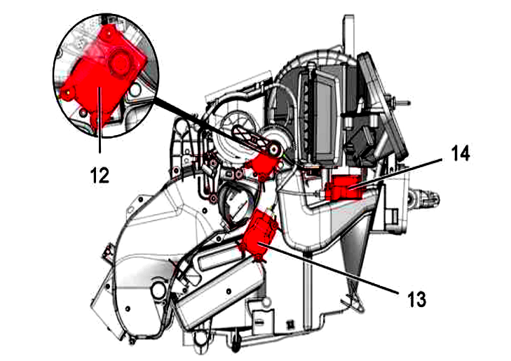

I replaced pollen filter, but bad smell enter in the cabin while passing next farm or driving behind old truck with black smoke. Is there a diagram for the location of that reduction motor?

The Air intake stepper motor is shown here at (14) on the right side.
