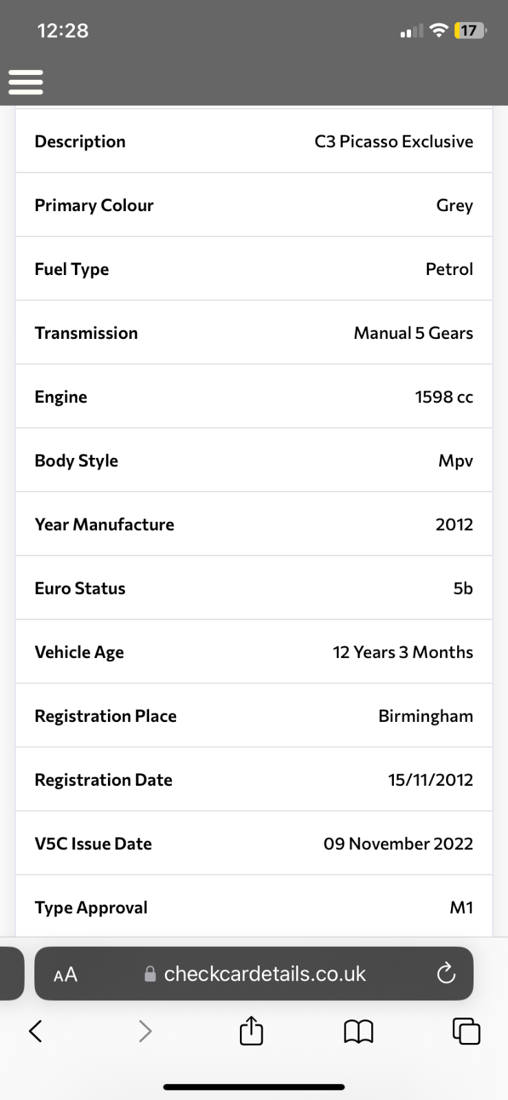

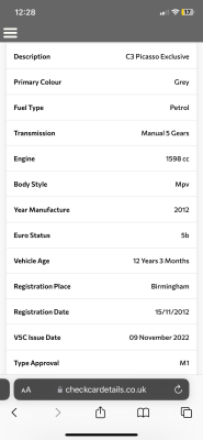

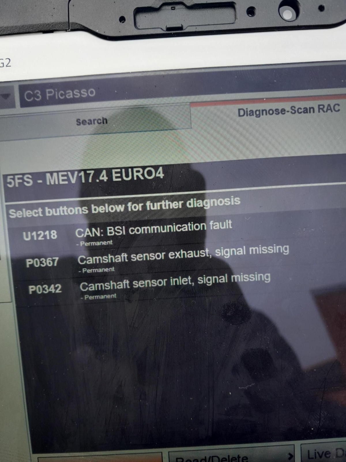

I just done a scan from the reg, not sure if this is enough info for you

The pic of the diag gives 5FW which does seem to be the Prince engine, which as you say is chain driven. However, no signal from the cam sensors still says broken / slipped timing to me. It could be a 5V reference issue, but as you have only these codes and nothing else, and a sparks has looked at it and come up with nothing, that seems unlikely. I would take the oil filler off and see if you can see a cam shaft, then get the engine cranked to see if the cam is going round. You've got a pic so clearing the codes will not do any harm - if they come right back then it's a circuit issue; but if they only come back at cranking then it's more likely a mechanical positional issue.
My money still on broken timing chain - but I'd be pleased to be proved wrong!!

Thanks for the effort richard, I’ve just ordered a new Obd, the one I currently have is a £20 thing hopefully the new 1 will give me some more info so I will wait until that arrives before clearing codes.
Someone did mention to me it could be a bsi issue and once I run through the procedure it could clear it.
What do you think about that ?
