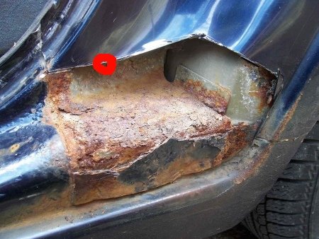

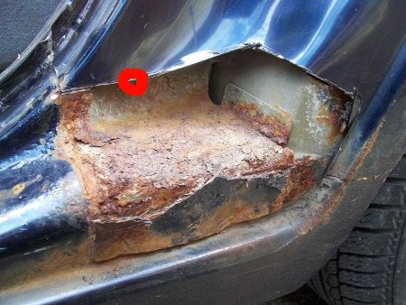

It is what is inside that matters most (from the cost point of view).....if you want advice about what you are looking at post some images of exactly where the problems are showing....that way people who "have been there" and those that know the inner structure can advise on the action needed.
For example, it makes a big difference if the rot is at the bottom of the arch near the sill or the top near/above the upper edge of the arch form.
As an example, this is a 3 skin area, there is another behind that inner rusty one !

Its in the lower sill vicinity not further up, i'm guessing youre going to say thats the worst case. I've seen some fixes on the internet but until i get into that area have no idea how far the rust goes.Stickyfinger wrote: 03 Feb 2025, 22:35 It is what is inside that matters most (from the cost point of view).....if you want advice about what you are looking at post some images of exactly where the problems are showing....that way people who "have been there" and those that know the inner structure can advise on the action needed.
