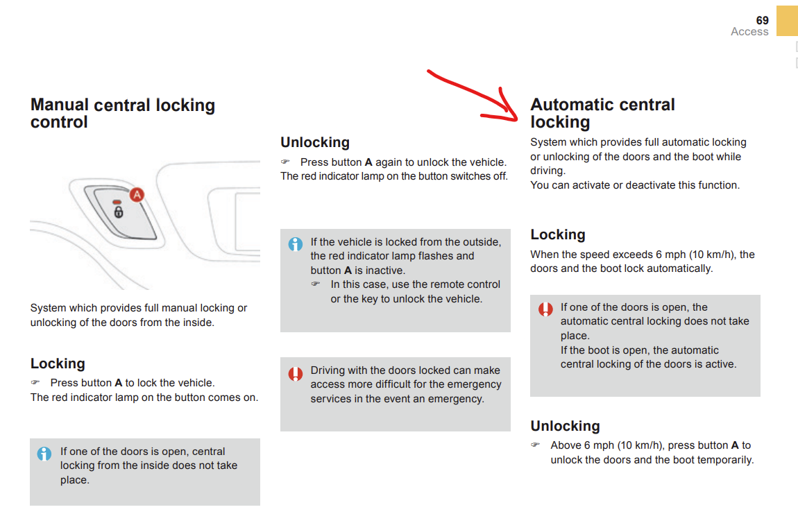

It worked a treat, thanks! Surprised this isn’t mentioned in the owner’s manual.
Thanks,
x 6954
Re: Auto-locking not functioning
It is mentioned under the 'Central Locking' section of your manual. :)
