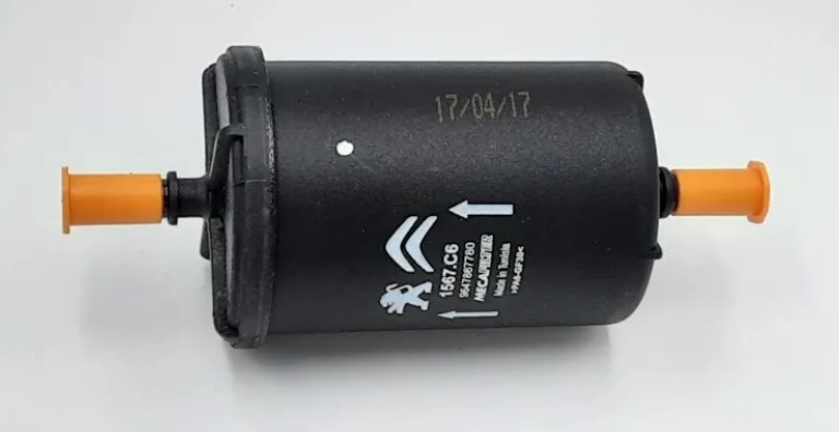

I could be completly wrong but I thought it had one of these near tank

I thought so as well. It's the same one I bought from the spares shop. Problem is that the car is so low to the ground, I battle to find ramps that fit under the front /rear wheels without ripping the bumper off. :-)

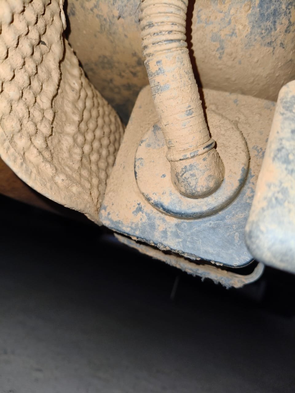

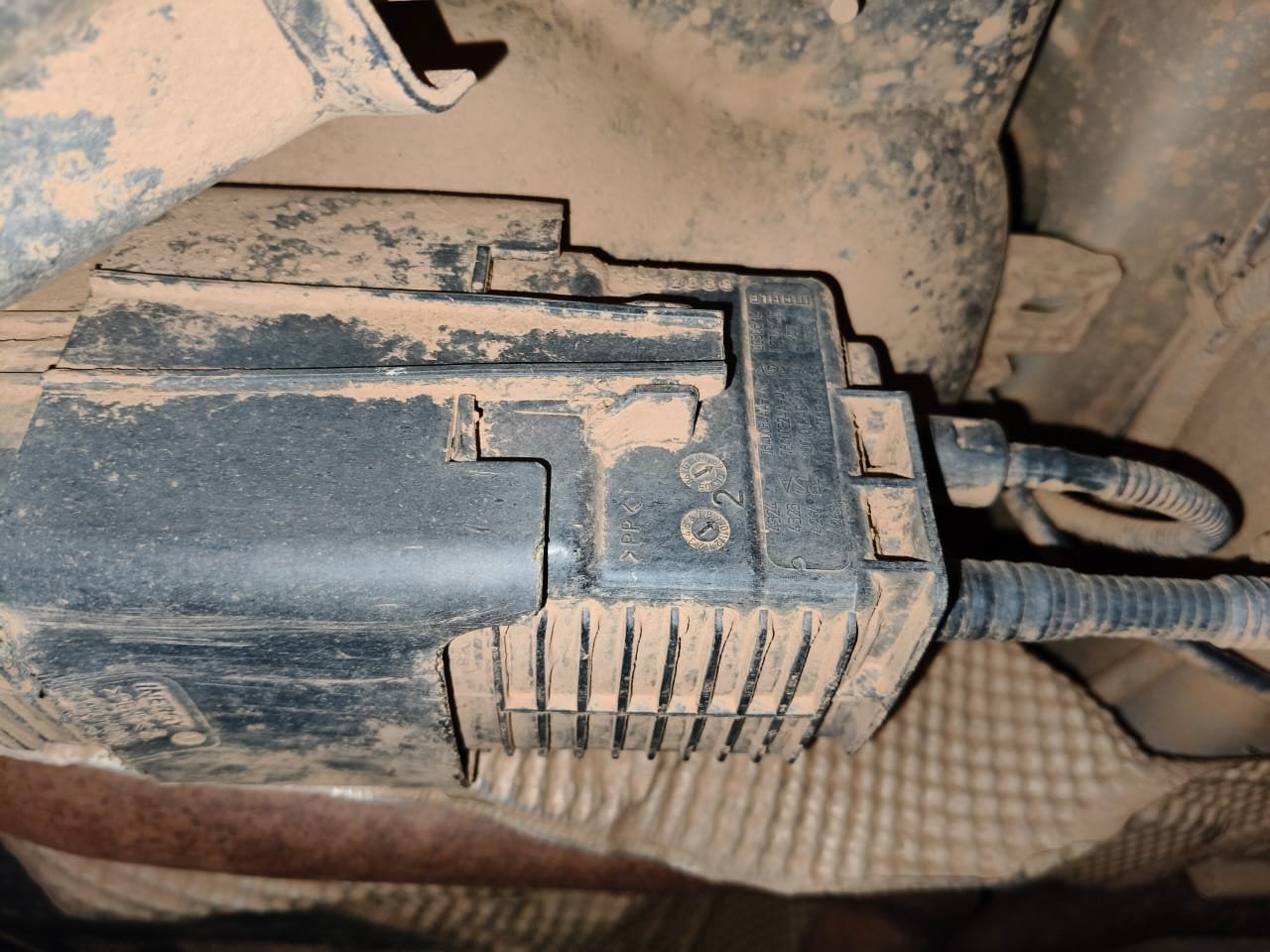

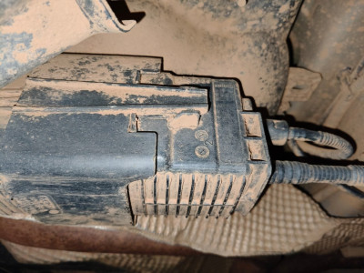

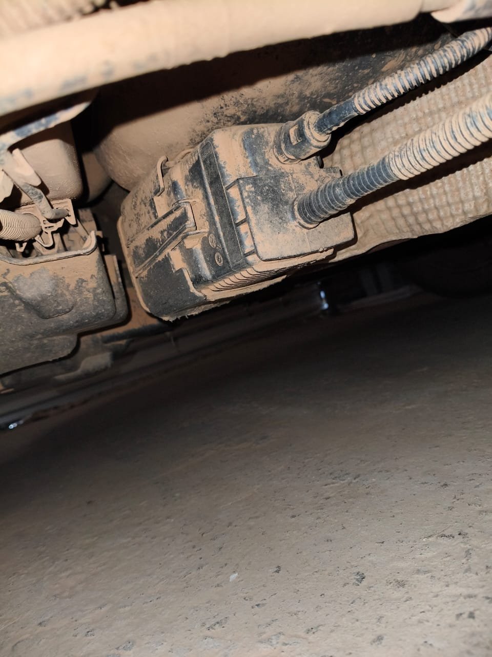

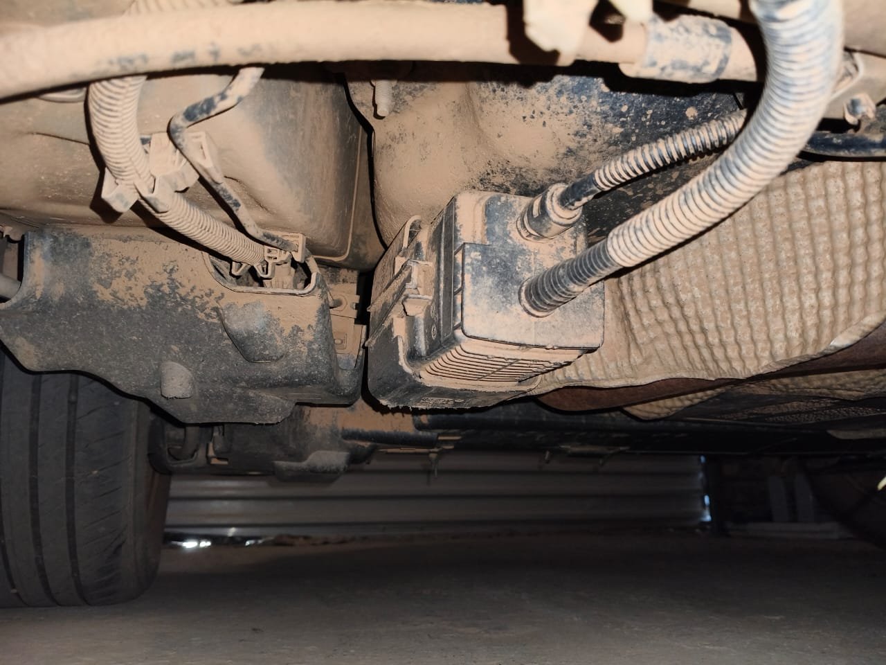

There is another "box" I found underneath the car, and looks like the fuel line run into this. I attached some pictures.
