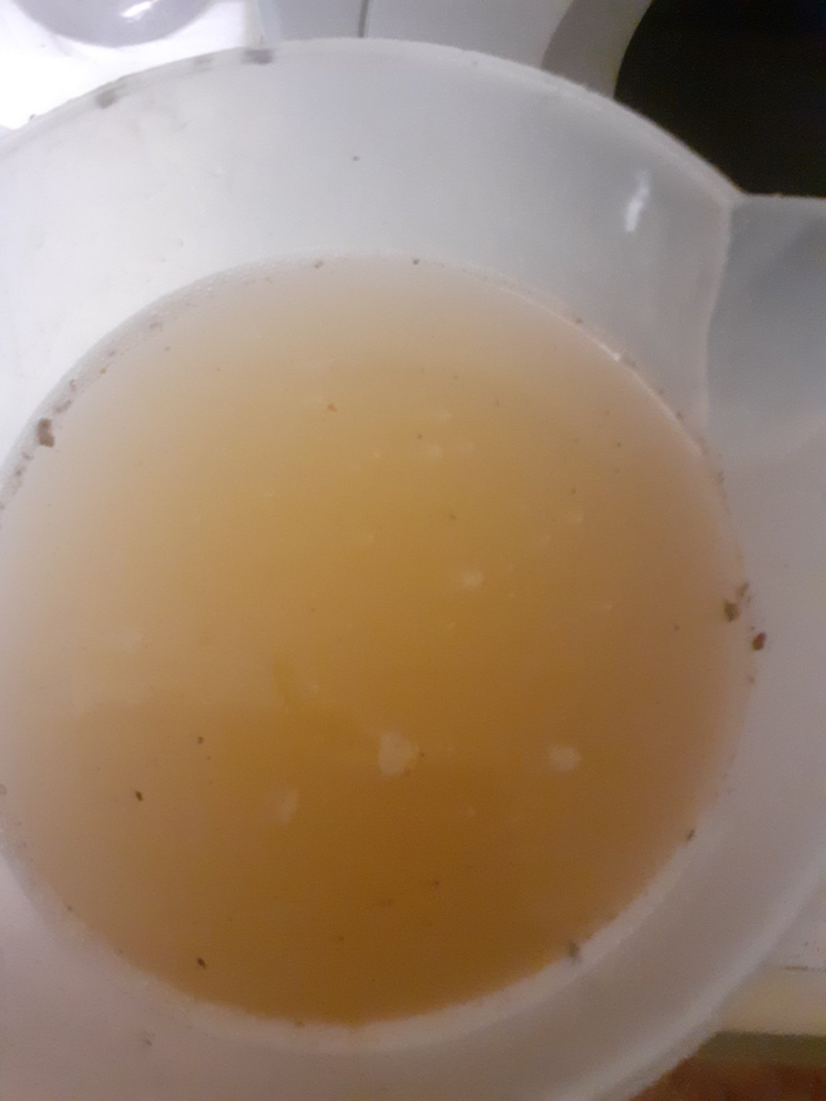

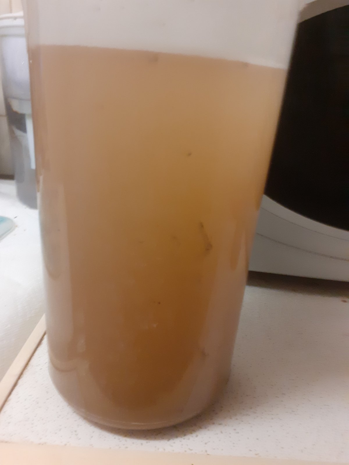

second job, get the elbow of and backflush the heater matrix, happily the elbow came of quite easily,made an adaptor for my hose and did the job, finished with some Forte stop leak and conditioner, I now have heat coming into the car.
This is what came out of the matrix.
