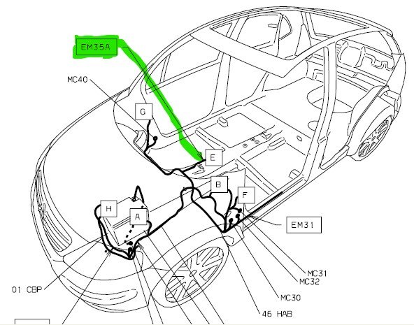

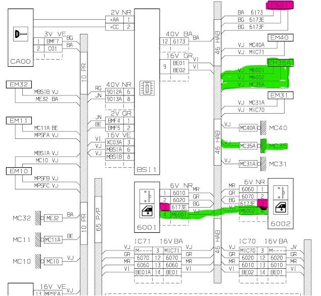

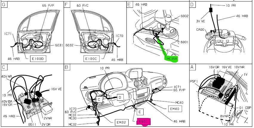

OK so the switches have a shared earth & a shared power supply, that's where id be looking. Both the earth & power supply also each have a splice where the wire splits to go to each switch.
Earths highlighted green
Power highlighted pink
