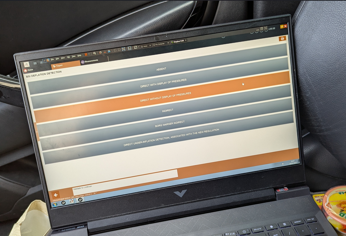

Anyway to get to the point of this post, while in the BSI configuration I noticed the options in the attached picture. It was originally set to "direct WITHOUT display of pressures". The check button only shows the 4 corners with OK on the display. I changed it to "direct WITH display of pressures" hoping that it would show the actual numbers in bar or something for each wheel instead of just OK, but nothing changed. I didn't really dare try the other different options in case they messed up anything permanently. Can anyone tell me if I need to change anything else to make that happen or is this setting just for some other car or hardware configuration or what's up with it? I assume if it exists there must be a way to get it working somehow or they wouldn't have added the setting menu for it? It would be really cool to see the actual numbers.

No - that is not a feature on this model.
I must caution you on playing with settings - or you may end up like several other members in the past that have complete bricked their vehicles by changing settings that must not be changed.
You forget that some BSIs are cross-range and therefore some settings were only applicable to other vehicle models and marques like Peugeot that have different display systems and functions not relevant to your vehicle.
