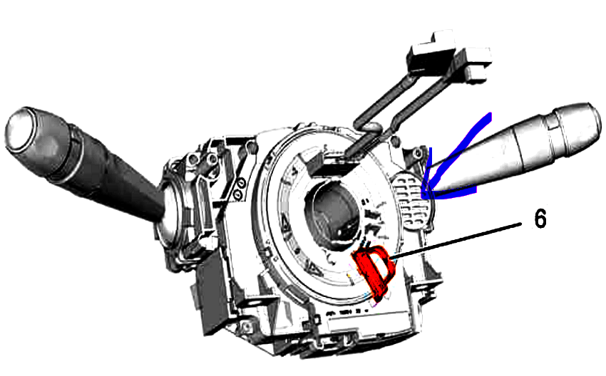

Re: Warning buzzer (beep) location
Control unit under the steering wheel contains the rotary module for the steering wheel angle sensor, so not sure what you are referring to and must be recalibrated if the unit is removed.
The speaker module can be seen here where I have arrowed if I'm not mistaken:

GiveMeABreak wrote: 29 Jan 2025, 12:01 Control unit under the steering wheel contains the rotary module for the steering wheel angle sensor, so not sure what you are referring to and must be recalibrated if the unit is removed.
Thanks but this looks like the comms unit from the newer models.. the one I have is a C shape comms unit, not one that pictured.

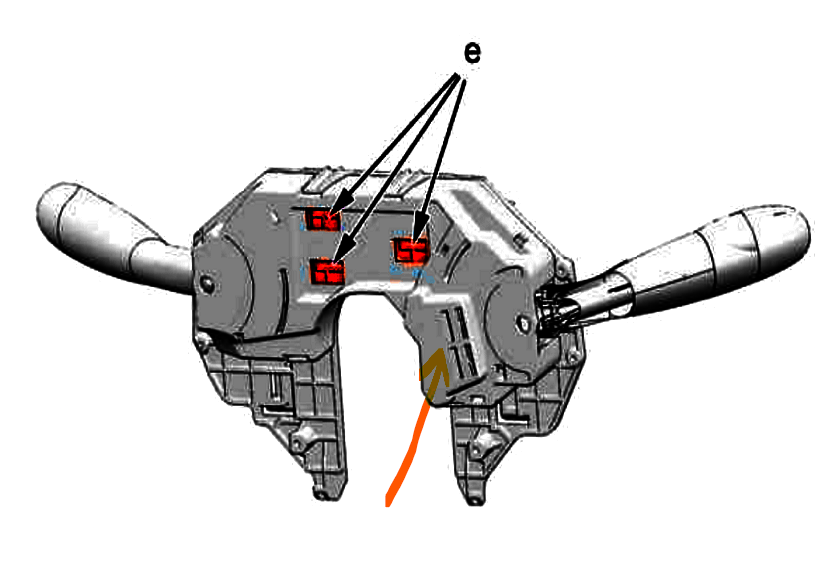

Best if you pop up the VIN so I know exactly what you have, as a C4 2010 model could be either variation as it was on the cusp of the change to the C4 (B7). Please post your VIN in full without spaces - it will be automatically masked from public view after submitting your post & will only be visible to staff.
However if it's the original older C4, then this will be it with what I believe is the speaker grille on the back arrowed in orange.
So it may be a sound module wired onto the board, as these are not supposed to be serviceable - just the whole unit replaced.
Unread post by scotcruz »
GiveMeABreak wrote: 29 Jan 2025, 17:56 Best if you pop up the VIN so I know exactly what you have, as a C4 2010 model could be either variation as it was on the cusp of the change to the C4 (B7). Please post your VIN in full without spaces - it will be automatically masked from public view after submitting your post & will only be visible to staff.
Can confirm thats not the buzzer.. its just some plastic bits for the turn signal.. there is no buzzer on the Comms unit.. search continues.
