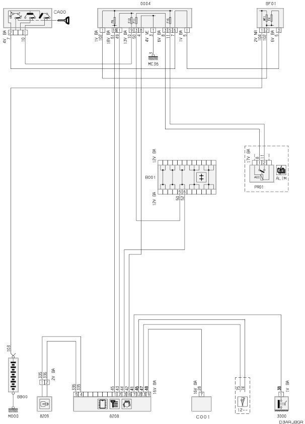

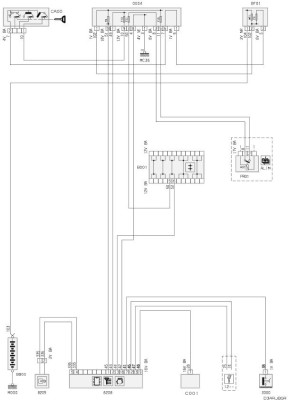

Have you checked all the fuses & fusible links?
Any more background info on the fault? had any work been done on the car just prior to the fault?
Using the diagram below check the power supplies & earth to the immo unit. Now with the new information you have added on about comms issues with other units you may find there is a shared fuse blown.
The immobiliser is a very basic system on this car & normally trouble free, never heard of an immobiliser control box failing on one.
