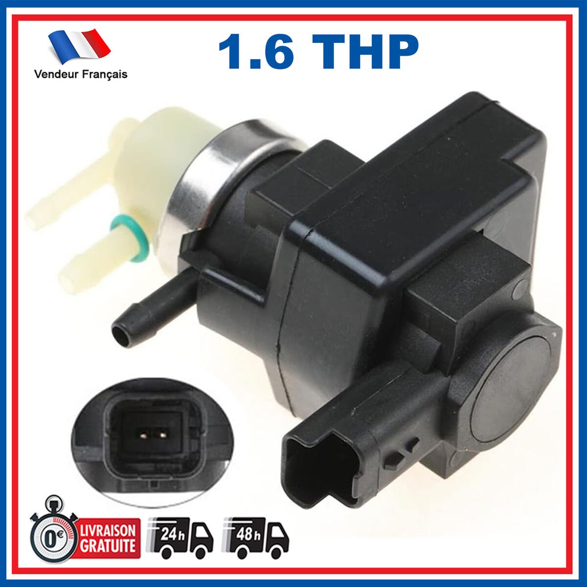

Can you confirm that the wastegate solenoid that was replaced is the one under the manifold at the back of the engine (not the dump valve on the turbo body)?

yes! It was replaced two times (2mechanics were working on it) already so faulty valve can be excluded I guess (pic attached)
I was told it is the one on the back left side standing in front of the car which controls the wastegate (not the one front right/centered)

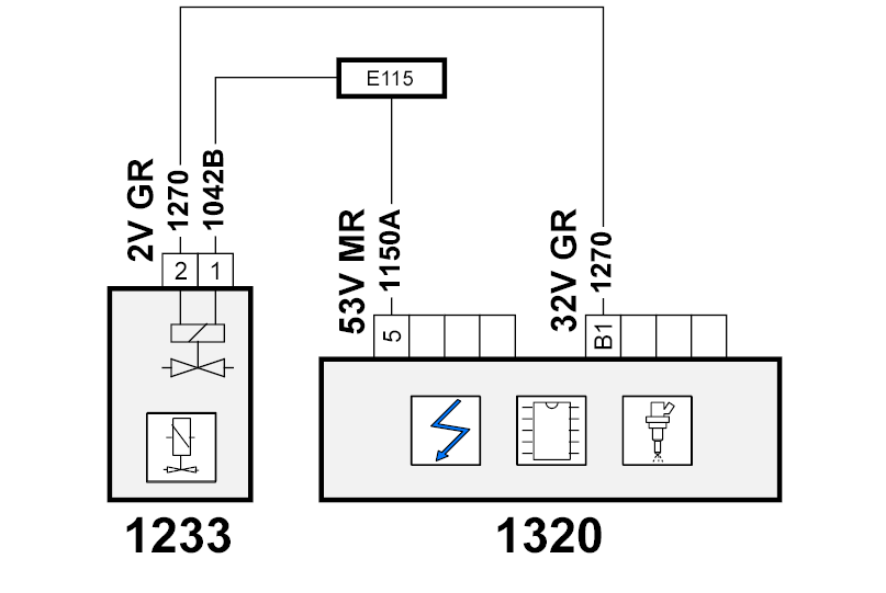

The pin connections for the boost solenoid are:
Where 1320 is the ECU and 1233 is the boost solenoid. 1270 is the control wire and the other is the supply.
With that fault present, the ECU is probably immediately going to a limp mode where it behaves as a non-turbocharged engine, but I don't understand why it is not putting on the engine warning light or beeping at you.

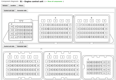

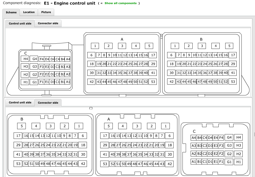

Just to be clear: checking the ECU pin scheme for all 3 connectors I see A1, A2, A3
1270 connects between solenoid pin 2 and ECU B1, right?
Do I have to care about 1042B/1150A wire solenoid Pin 1 to ecu pin "5"? And if so is pin 5 on ecu "B5" as there is "A5" existing too?
Once checking wire(s) measuring between wire 1270 solenoid pin 2 and ecu wire B1 should be ~0 Ohms to realize wire is OK?
And yes, I don't have any further indication like MIL or Navi display error message or additional fault codes maybe also indicating that wire is okay but ECU not behaving as it should?!
If I would not have tried to overtake someone I would not have noticed this issue too.
In electricity there is always at least two wires. So connectors at solenoid are supply to power up-trigger the valve and you have to check bolth wires. El.charge can't move if any of the two wires is cut.
You should see measured value from one end to other end of the SAME wire approx. 0 ohm. I would disconnect conectot at solenoid and ECU, shorten bolth pins at solenoid end and measure resistance btw pins that go to ECU. And also btw. wire and ground point on chasis. That should be infiniteli big.
