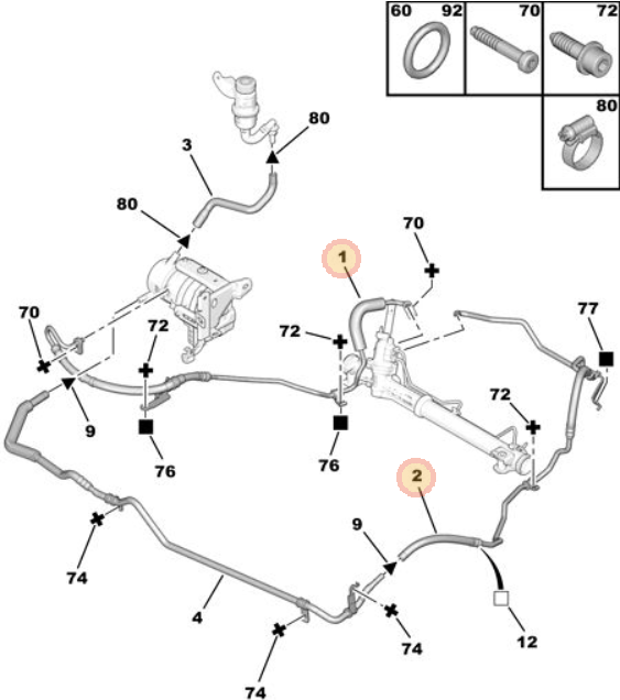

Back to the steering rack:
A word of caution here. Although the racks are available, both the low and high pressure steering pipes are no longer available from Citroen! So be very careful if removing these as they will likely be weakened on removal and refitting may not be easy or can lead to leaks if they won't seal properly.
Pipes
(1) is the high pressure Steering Pipe (part: 4014NV) - no longer available
(2) is the low pressure Steering Pipe (part: 4012V3) - no longer available

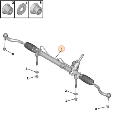

Rack
(1) New Steering Rack part: 9801433280, £1,919.72 inc. VAT
This model has a 184 ° Steering Rack Angle.
