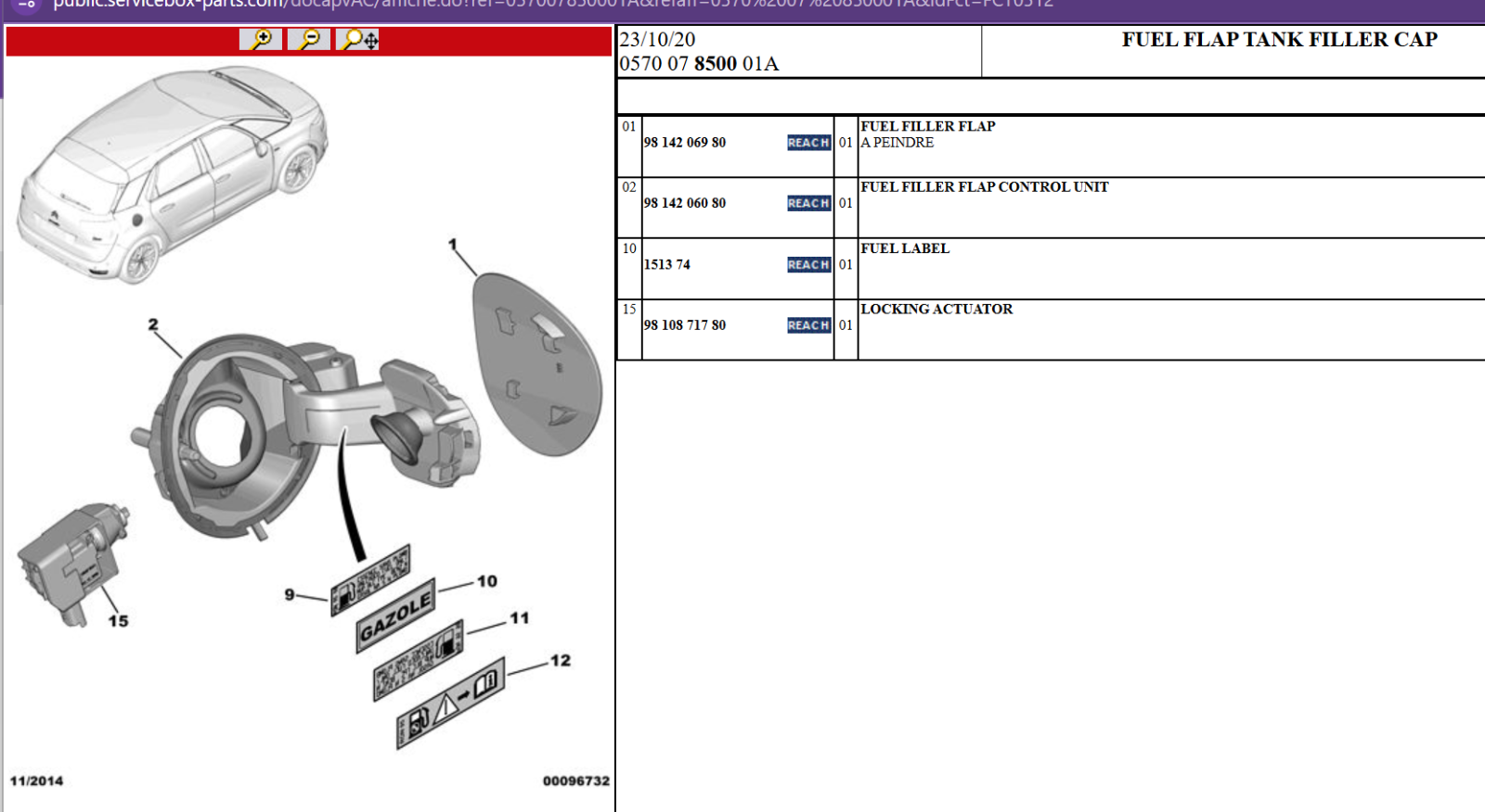

Re: Fuel filler cap not unlocking - Citroen C4 Picasso 2017
Here's the diagram for your car:
Showing a different part number for the actuator - 9810871780 - £35.86
No idea how you get to it - via the wheelarch possibly? Is is the actuator not unlocking it, or is the other that holds is shut faulty? On Mk1 cars the end of the pin used to catch and prevent the flap opening, could be fixed by shaving a bit off it.
It's definitely the actuator that was dying.
I've had a look at it to see if anything was catching, and you're right - it's the part number you quoted, not the one I had initially.
I've ordered a new one because after locking and unlocking for ages to finally get it open, it now won't lock at all.
When you push and it opens, then you push to close - pushing is no longer doing anything, it's just springing back open. It's not pushing and clicking back in.
