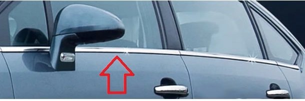

One thing you can try that saved my butt with my Chevy Cruze:
If your car has a removable window trim on the outside you *may* be able to spot the lever that connects to the inside of the handle, which outta open the car even when locked.
On my car the locking mechanism only disconnects that lever from the outside handle, and so I could sneak a string around the lever from the outside and pull up - voilá , door opened.
Will take some fiddling but might work on yours too.

Thanks for that suggestion. Supposedly another locksmith is coming tomorrow who will try to pop the hood open to get to the car battery and put power to see if the battery is dead. I will tell him about the window trim idea also to get the door opened.
