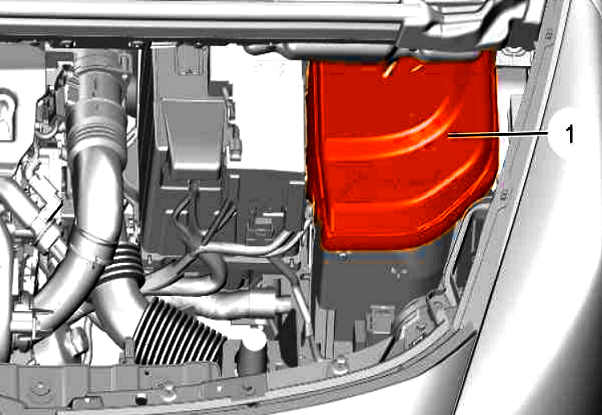

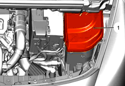

The engine ECU is under the cover shown at (1). Remove this to reveal the engine ECU and connectors.
