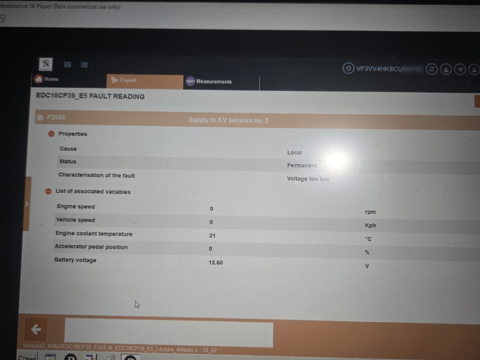

The new DTC, DTC P2685 Supply to 5v sensors no 3
What possibly does P2685 actually mean on DW12ME5 ?

I can unplug the Fuel Pressure sensor and clear the DTC P2685, but it comes back, when I plug either the old sensor in or the new one.
I can't see much information published about DTC P2685, am I on the right track for this engine, and would be interested in any feedback about this.
