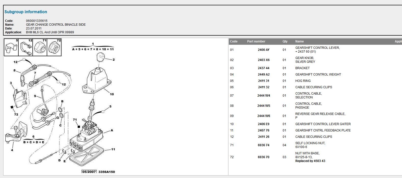

This any help ?........... the best thing to do is to post you Vin number(it will automaticity hide, only forum staff can see it) & ORGA number which will allow better searching/info to be found.....
A donation to the forum opens up ALL the info Citroen Service hold etc.....for a good few years...well worth every cent/penny.
https://catalogs.ssg.asia/citroen/?lang ... VDAwMTg%3D

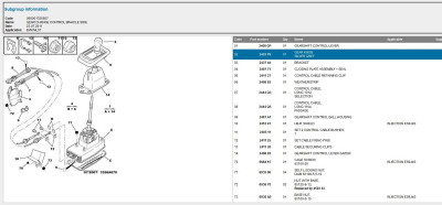

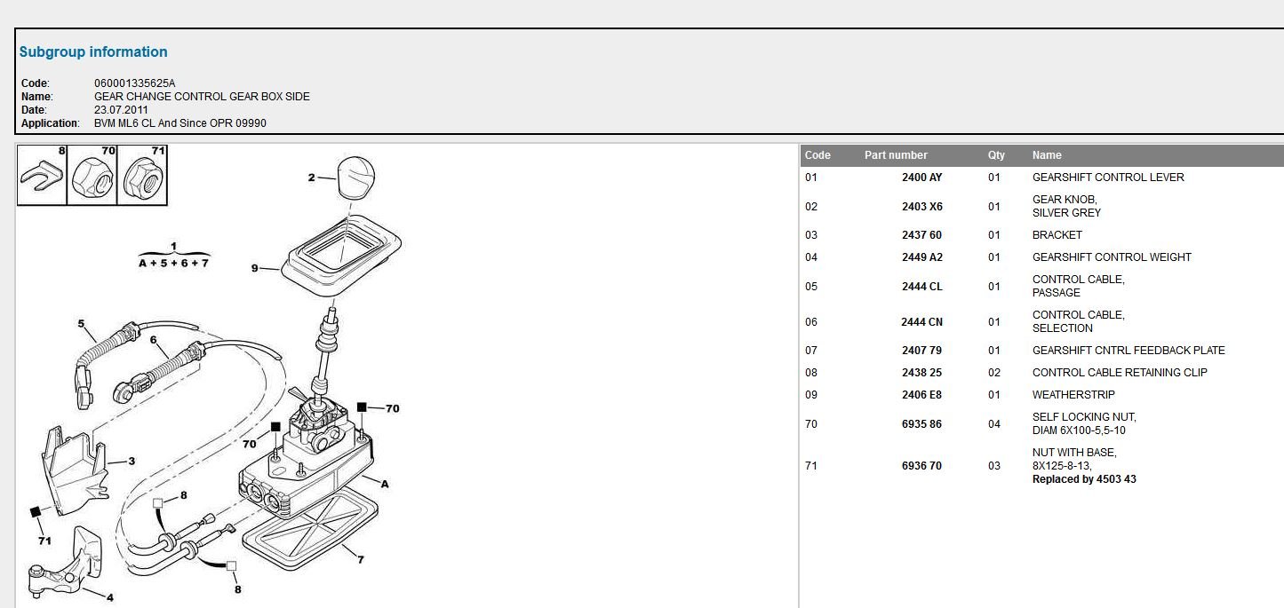

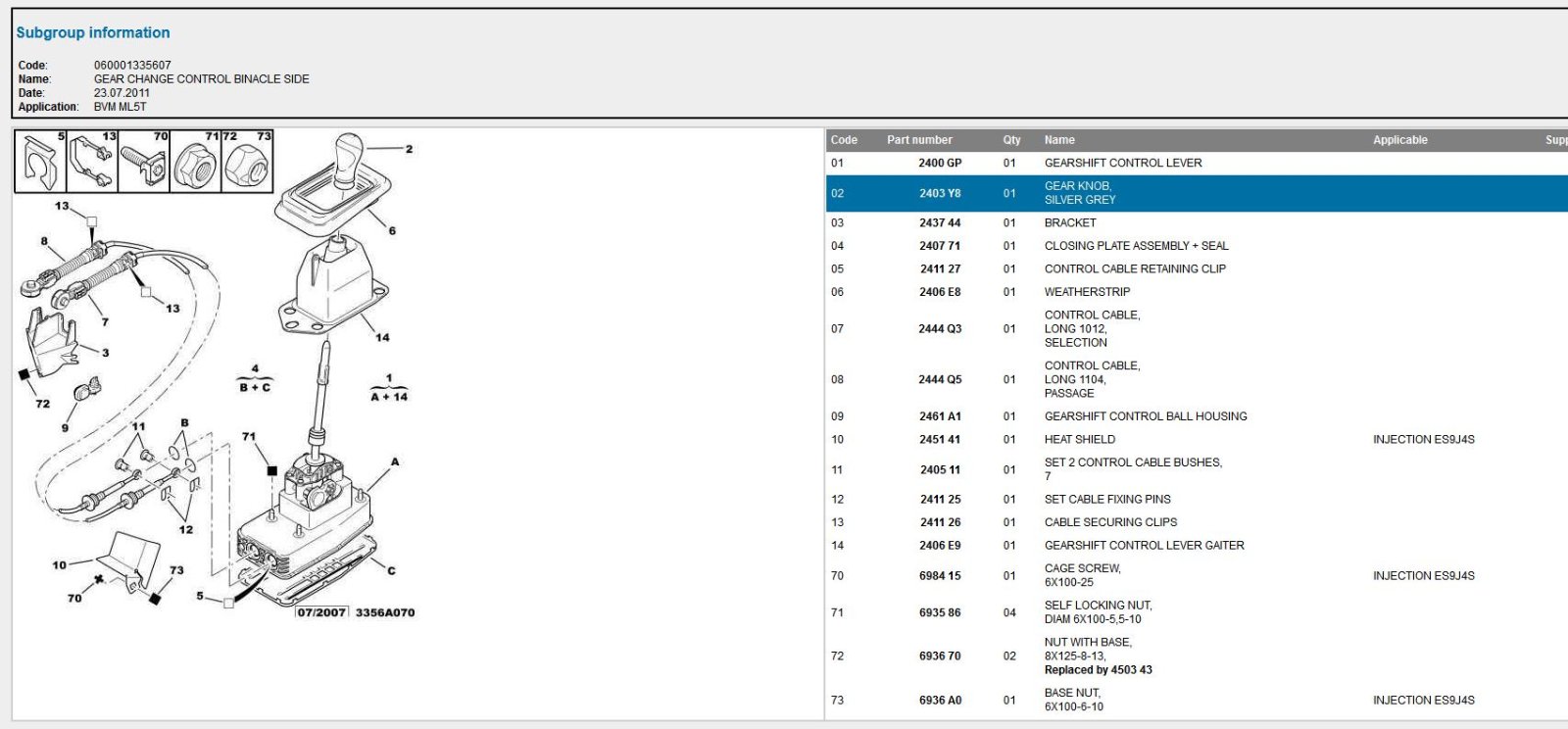

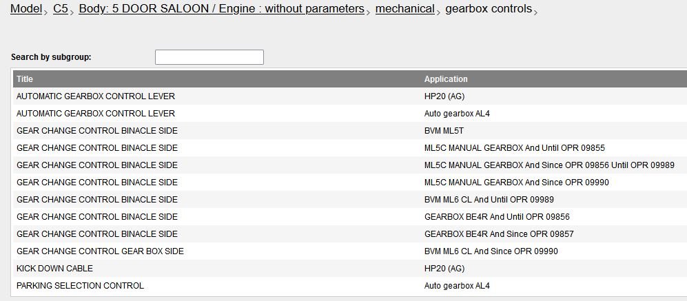

There appear to 5 different sets depending on which box is fitted....
