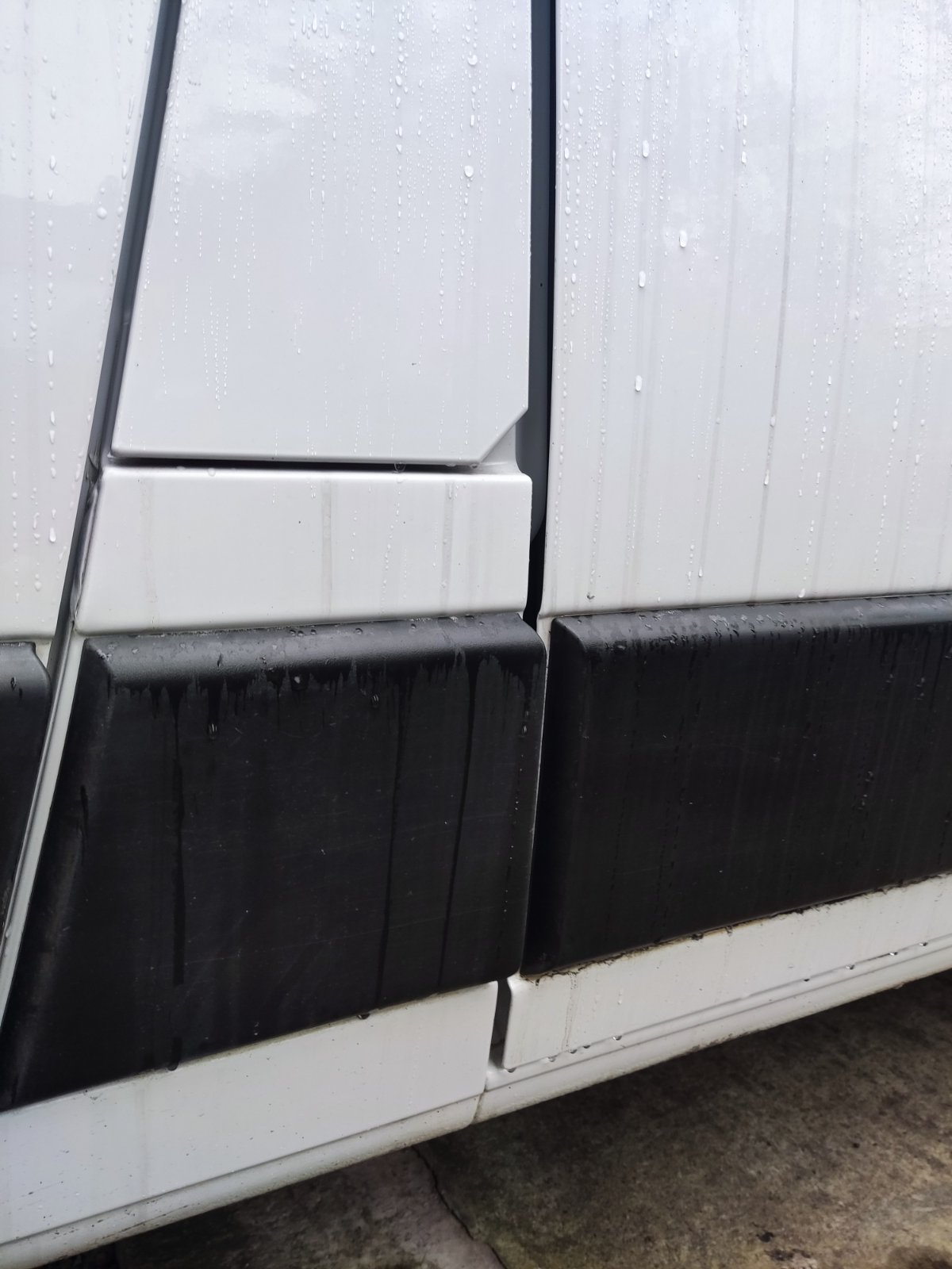

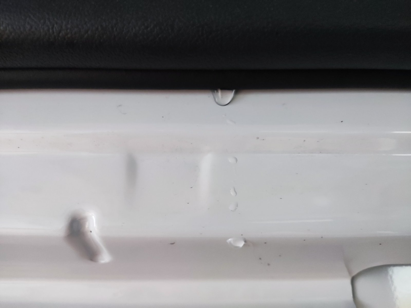

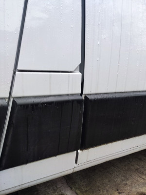

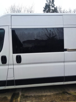

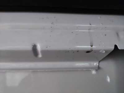

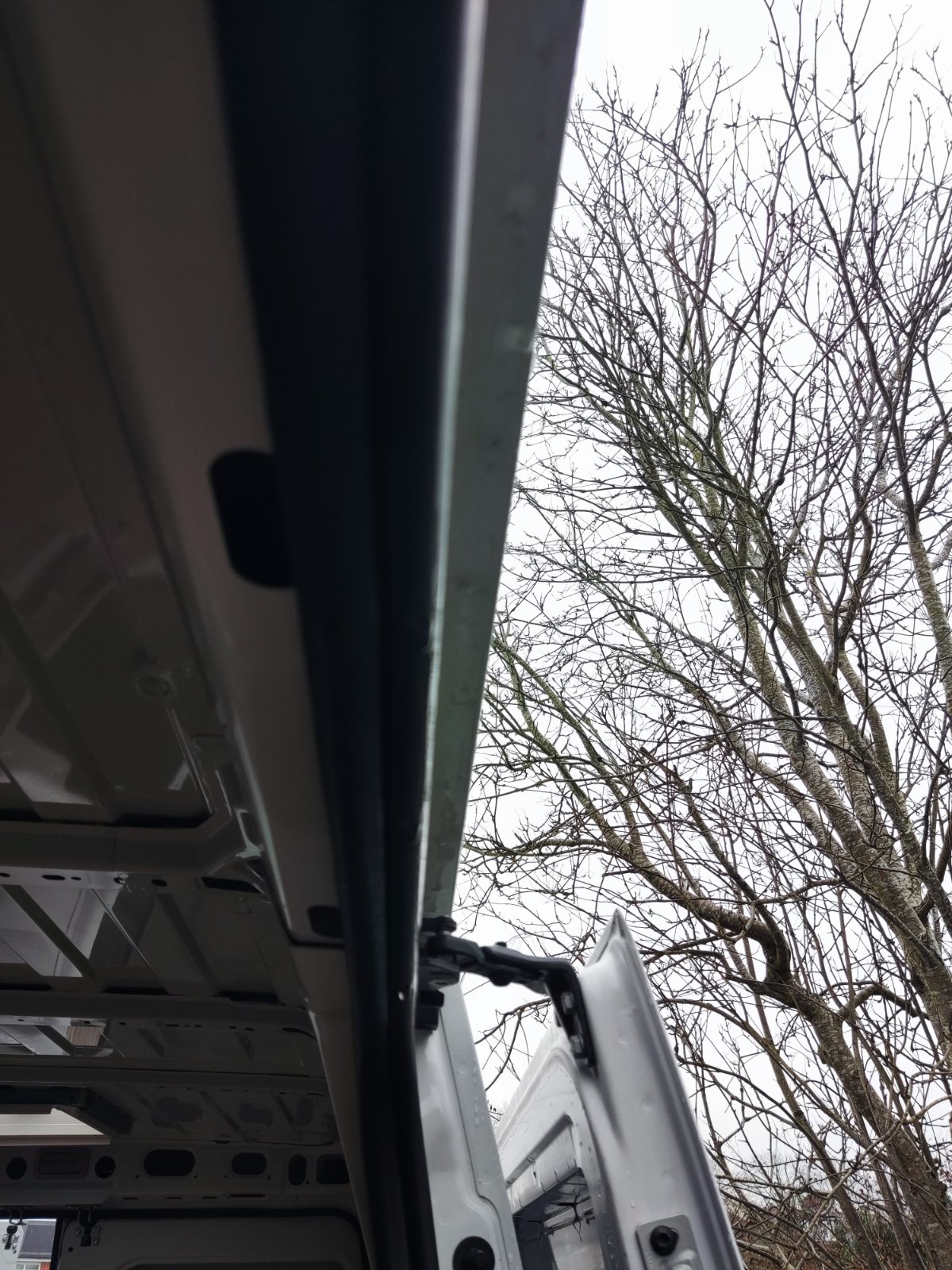

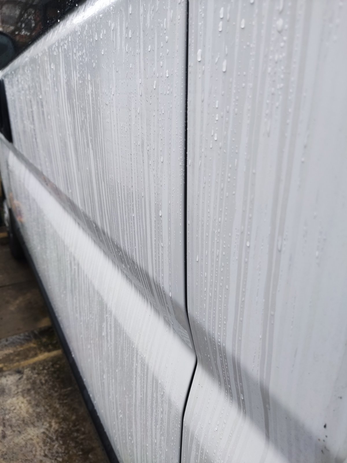

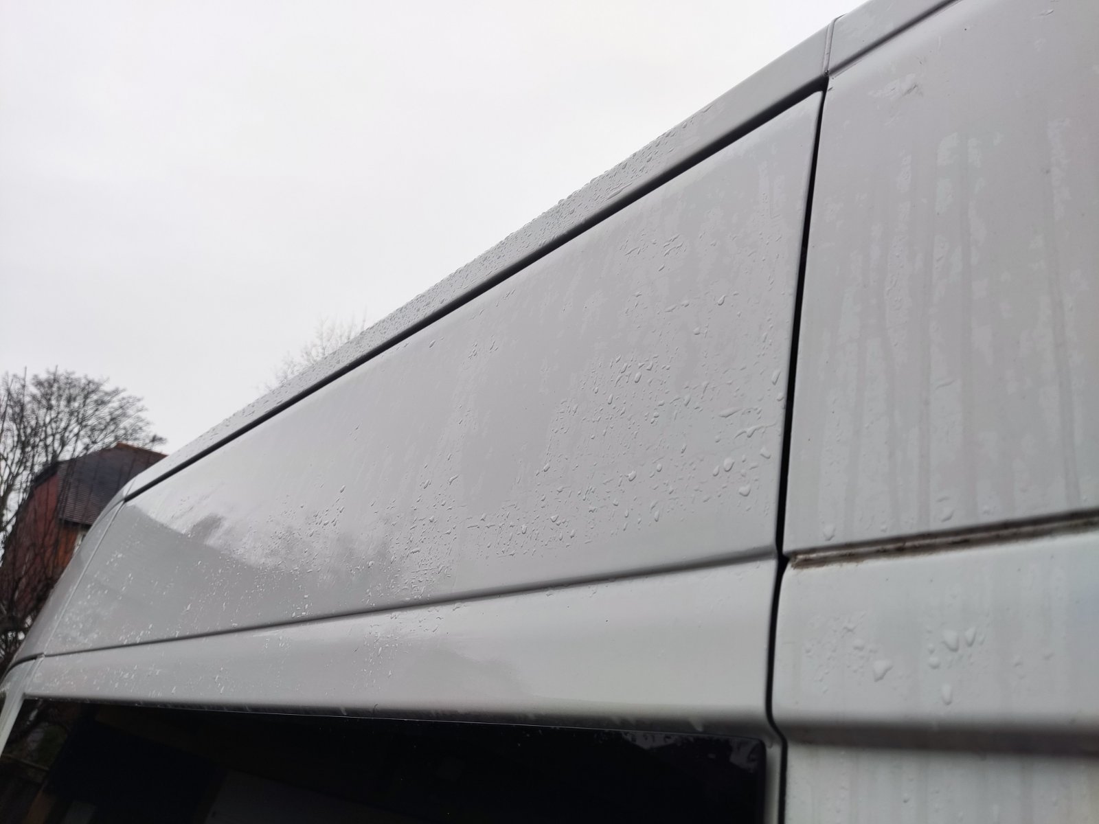

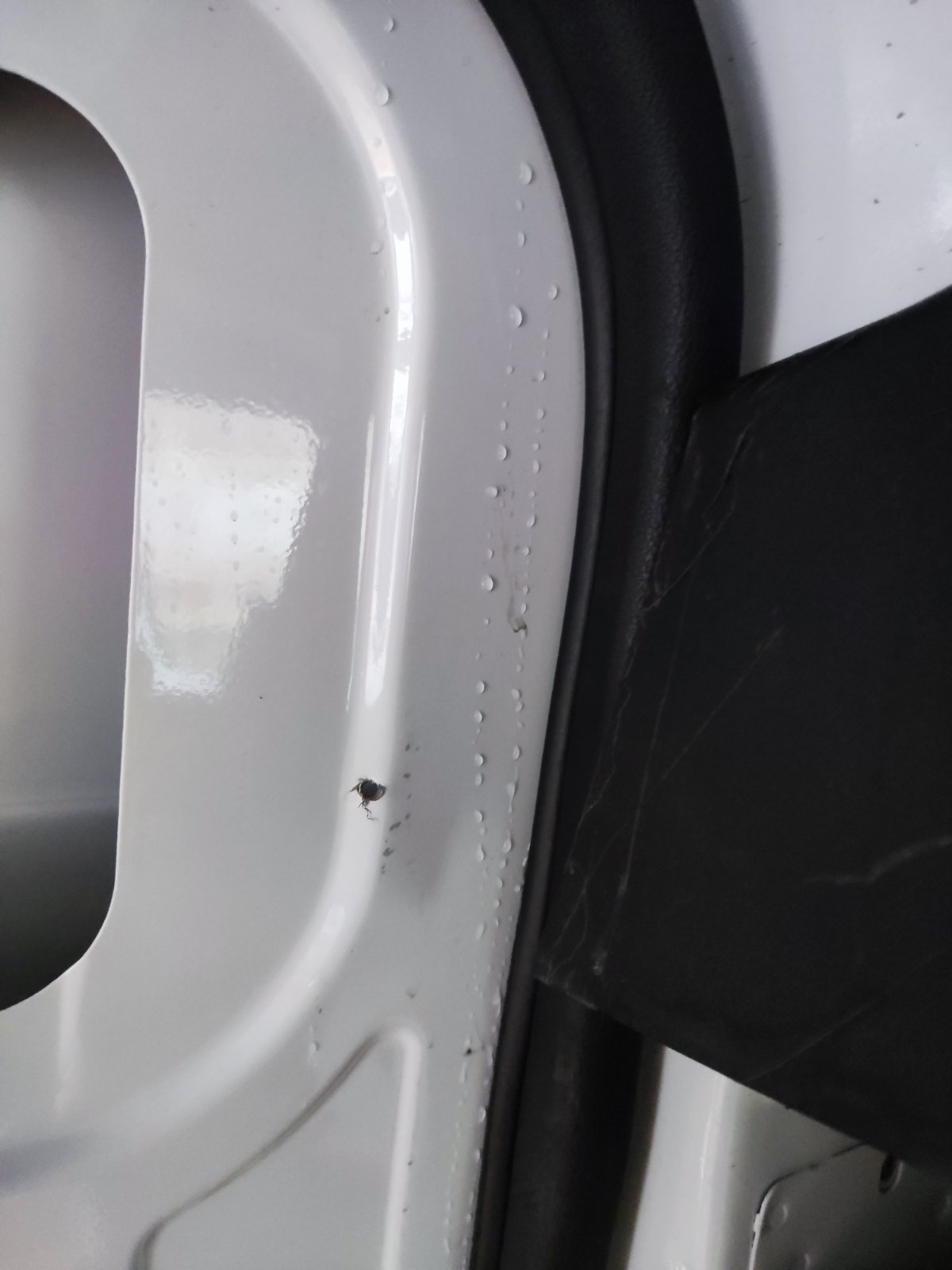

Hi,
The side door on my boxer is dripping from the top seal when it rains. Mostly near the front but also a little in the middle. The seal itself looks to be in good condition, its only a 2022.
The door closes very easily, compared to my previous 2016 Relay van where you had to give it a real whack! I'm wondering if it needs to be tighter against the frame :?:
Any advice much appreciated I'm fed up of a soggy floor :)

I'm thinking you might need to adjust the rollers both top, mid and bottom *just a smidge*, so that the door is pulled closer to the frame when closed.
If the door indeed closes very easily it doesn't make snug contact with the seal all the way around.
All 3 rollers are easy to adjust, but make only small adjustments at a time and test it with a water hose until it seals proper.

Seems like good advice. The door does appear to be flush with the frame as it is but maybe a 1mm tighter fit will make all the difference. I will give it a go
ta

I think the smidge worked! Adjusted each roller by about half a mil and the watering can test showed no leaks :)
Thanks very much
