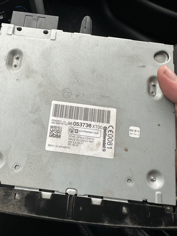

This unit is the RD4 or RD45 system, made by Continental.
Usually standard equipment unless another system is specified as an option. There are Single & Dual Tuner versions. RD45 features over the RD4: The RD45 has USB connectivity & integrated Bluetooth module supporting Phone & Audio Streaming.

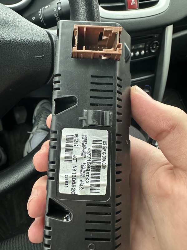

I have Peugeot 207 2011 with rd4 unit and type a display, i bought used type c and rd45 unit, rd45 unit works with type a display but type c does not work with rd4 or rd45, only background light, so i guess i need to code something with diagbox. Can you help me how to code it.

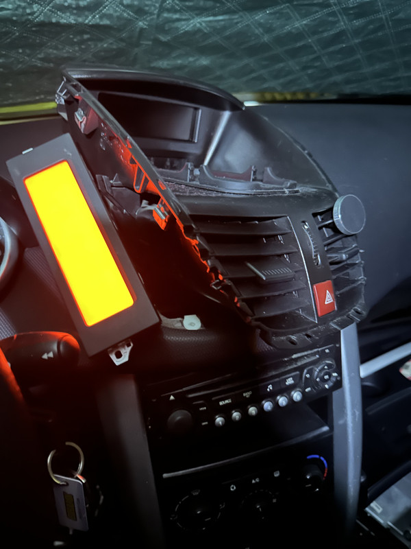

Update, display was dead

New display works perfectly except i need to code board computer in menu options because new display is from peugeot 3008.
