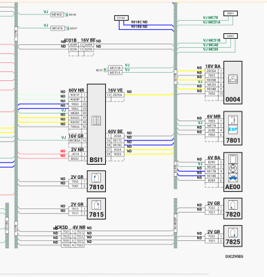

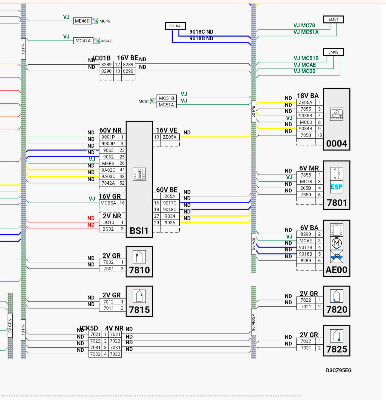

Since the rear d/s abs sensor (7825) wiring has been repaired before ( by garage), I'm thinking if it's that again I think I would be tempted to run a new twisted pair ( 7032 and 7031) between the sensor and connector pins 3 and 4 on ICK5D ( soldering and sleeving as close to each end as practical without de-pinning connectors. What wire type / gauge would be suitable for a twisted pair? I was thinking at first maybe a length of Cat5 network cable but the gauge on that is probably too fine.
Conscious I might have to consider the wiring to the h/brake actuator too which I think has +/- ( 7034 / 7036) and a twisted pair (7038 / 7040) but that doesn't go to the same connector under the back seats.
Finally, is it just the centre seat to remove to get to ICK5D?
