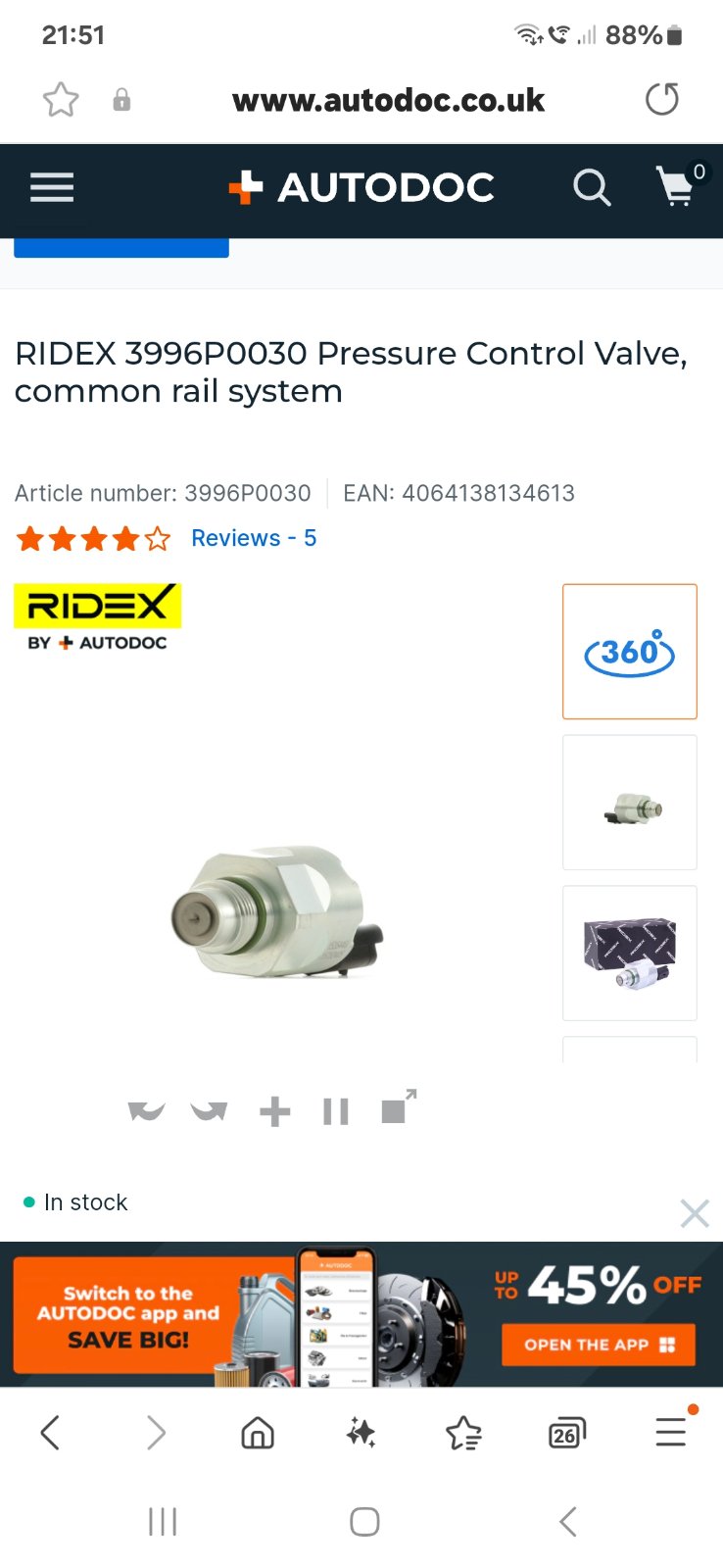

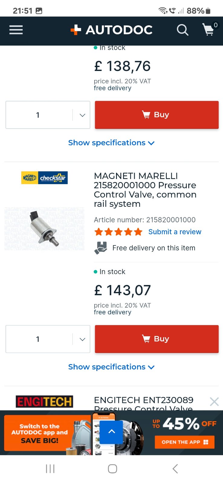

Changed the maf and fuel filter. Next step is the fuel pressure regulator. These have been discontinued by Citroen in the UK so I'm having to get one off auto doc. It gives me 2 totally differant options when I put my reg in. I can see the screw in one on the bottom of the fuel pump. Will I have the other one as well or will it just be the 1.
I've attached photos of the 2 options from autodoc.

is my engine likely to have both the pressure regulators i put pictures of it will it just be the one i can see.

I doubt your fuel pump has 2 pressure controllers, I do not know what you searched on but possibly they are for different model pumps. If you want to try PF Jones you could phone them and ask. Looking at the ones on the PF Jones site there are 2 different ones depending on the engine code for the 2.0 hdi. The engine code is in the VIN so that might help.

Morning Paul. it has one at the top of the pump that attaches with 2 bolts and there is one on the bottom that screws into the pump. ive took them both off last night and both part numbers come up with common rail fuel pressure regulator. ive sourced the one on top of the pump but the only place i can source the one that screws in is auto doc. ill change the top one first.
