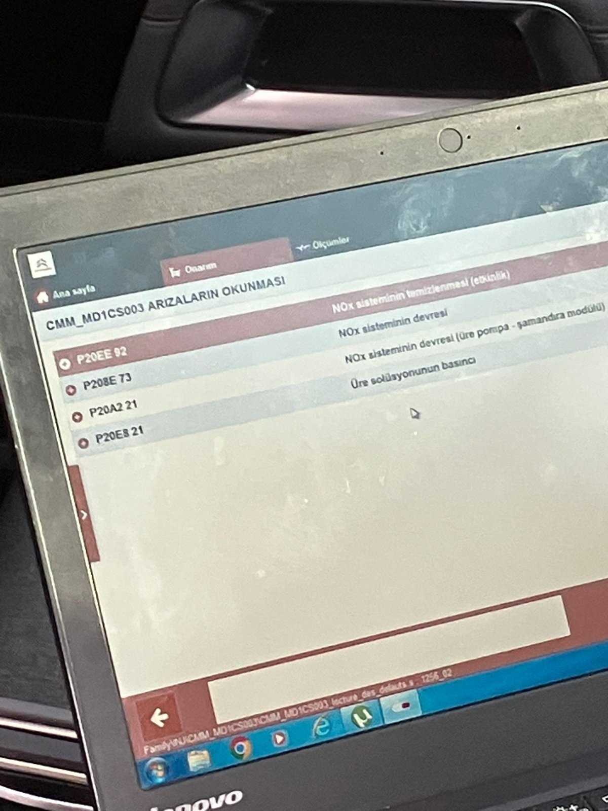

I have 2019 Citroen C5 Aircross 83k km (appx. 53k mile) car. (Engine is 1.5 lt Diesel blue HDI) 2 weeks ago ? saw firstly engine check light and adblue light at my screen. I went to service and they said change ürea injector and adblue tank. But tank cost is really high. We changed ürea injector and I added new adblue+tunap987 (scr cleaner liquid). After 1 week both light came back again. We reset it. Because I need time for cleaner. But again after 1 week - this thursday lights came back.I continued using my car without doing anything. Today all light turned off. This is very interesting for me. I dont know what to do.
I saw 4 different failure code with obd control. You can find the picture at the below.
I really want to know your valuable commets. Thank you for your all support. Happy new year!! Greating from ?zmir-Turkey.

Did you tell ECU that you changed injector

repair service made a change injector. I think they did it.
