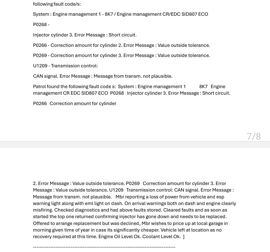

When the car was first diagnosed, I was told injector 3 needed replacing. I've just been sent the full report from the AA (extract attached).
It mentions all kinds of codes, including PO266 and something about cylinder 2. Can anyone shed any light on this? Does it mean other things were wrong and does it give any clues as to what they did to put it right?

Only just spotted this. There's 3 main erors there.
Injector 3 short circuit - this could be an injector fault, or a fault in the wiring loom.
Injector 3 outside tolerance - on it's way out anyway.
Injector 2 outside tolerance - also on it's way out.
The repeated replacement of no3 makes me suspect a wiring fault as well as an injector.
That report also says you declined a repair - was this at the first or second fault? If it was the second time, where did that first replacement injector come from? I know it's gone now, but always interesting to at least get close to the root of the problem.

The extract of the report I copied to here...
I did an FOI request to the AA and they sent through everything that they had on file, including this. It contains a lot more detail than the repair summary which they originally sent eg. I wasn't made aware that they'd found any issue at all with injector 2 so this was news to me - perhaps something I could have shared with the main dealer to give them a clue where to look if I'd known.
