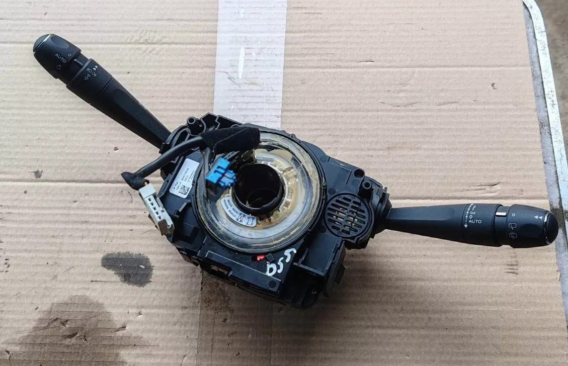

hi all i wonder if you could please supply me with the part number for the stick coms unit for my ds5 as i have lost all my comms sounds and belive it to be this unit as faulty

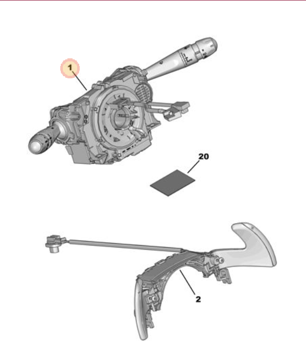

Hi Paul - please put any future parts requests on the official parts thread, so your request isn't missed, thanks.
Official Part Numbers Thread
(1) Multifunction Control Unit (Com 2008), part 98199448ZD, £542.88

in your opinion do you think this is the fault as i cannt find anything in diagbox to turn them on only to play the sounds and this dosent make any sounds i have tried this section on my wifes C4 and the car plays the sounds

I think I saw somewhere (probably not on this forum) someone who found the little speaker in the comms unit had failed, and he managed to replace just the speaker with one from something else.
