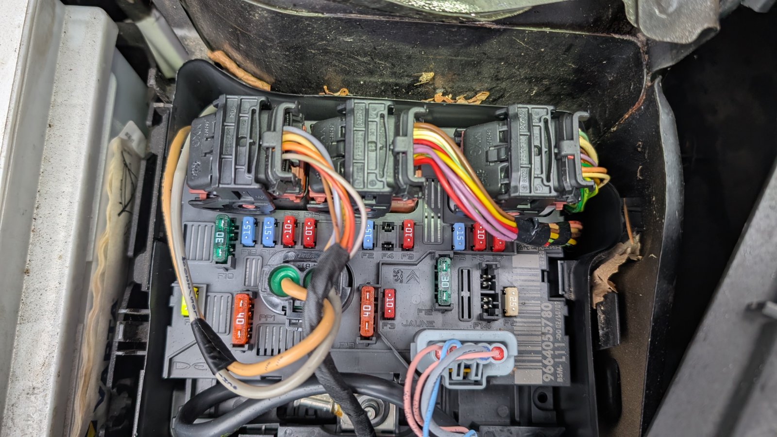

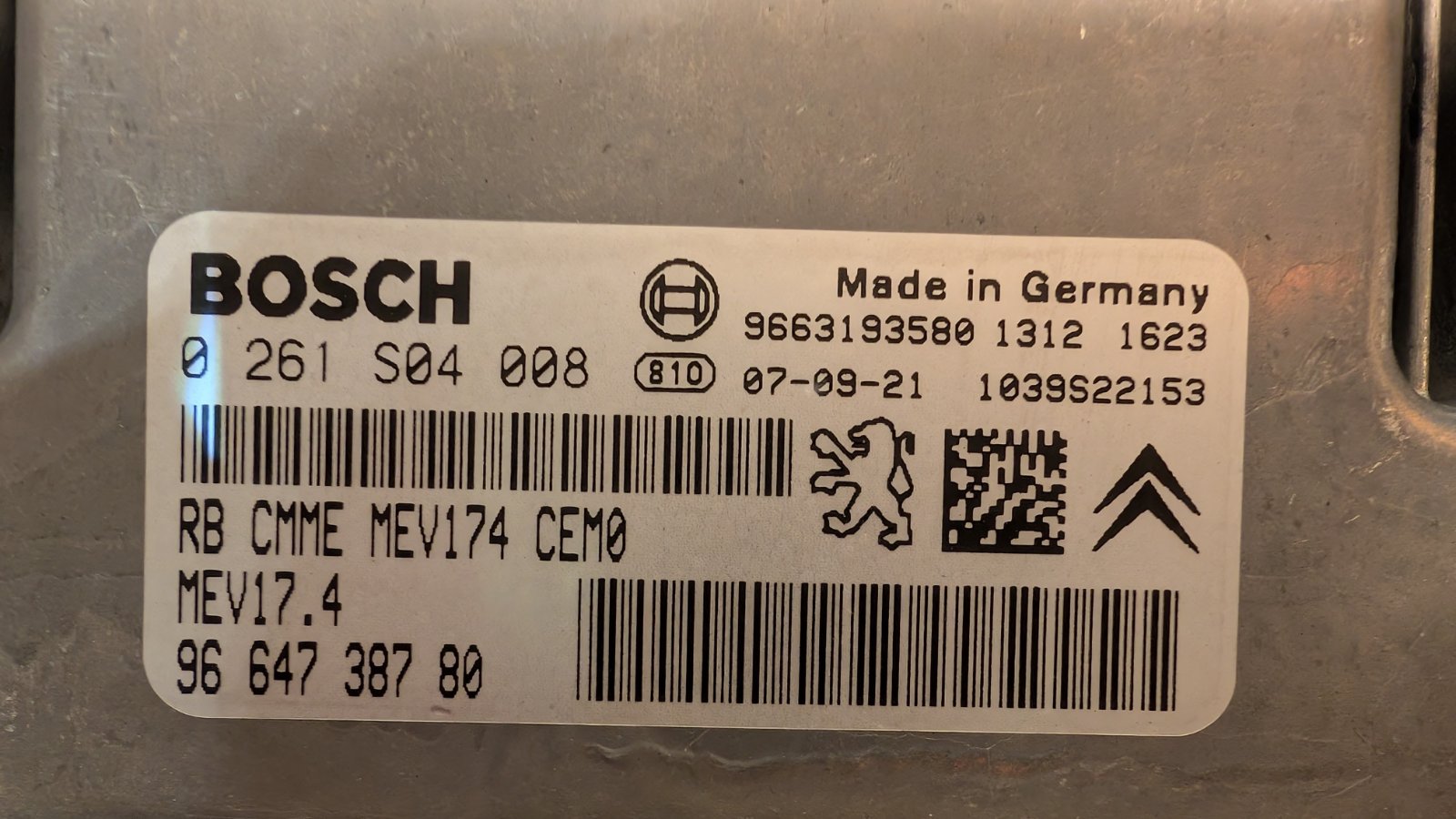

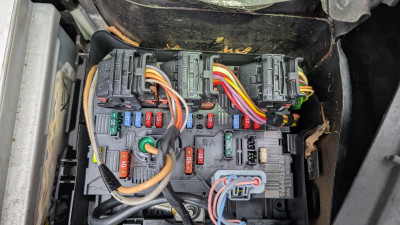

My Peugeot 207 1.6 VTI 2007 with some issues with Engine Fuse F5.
It look like short-cut in the cranckshaft sensor wiring.
I replaced the oil pressure sensor, cranckshaft sensor but the issue is not solved.
Who can help me is it the:
- ECU
- Wiring
- Engine Fuse box
Were can I find diagrams of the ecu cable connection to check the cranckshaft wiring

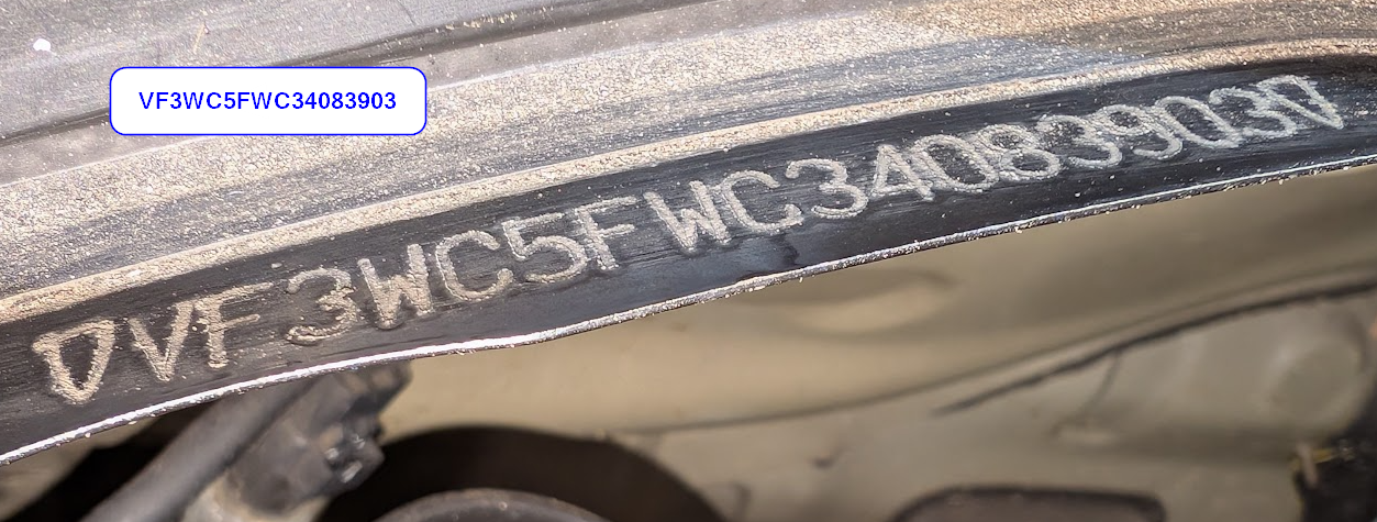

Hello guys,
here is the VIN of my car maybe this helps:
regards,
Guustaaf

https://www.startmycar.com/gb/peugeot/2 ... orfusebox1
F5 Fuse MINI15A Fuel pump (gasoline), Turbo solenoids (1.6 I THP 16V).
If you look here, you will see what F5 is for. It has nothing to do with the crankshaft sensor.
You can disconnect the connectors on the pump and the solenoid. Then put a new F5 and see if Blowing.
