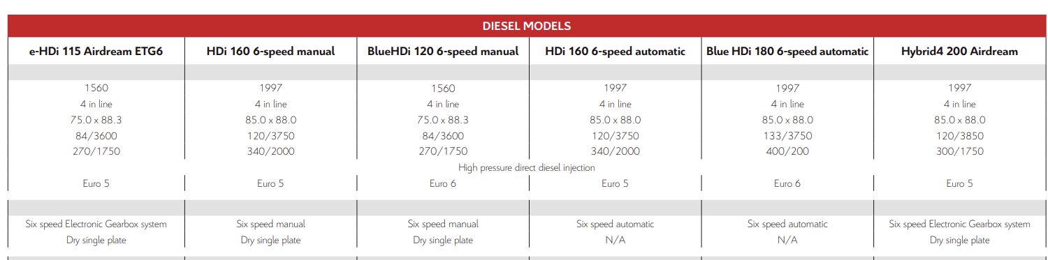

From what I can tell 2014 specs and the AM6 6 speed Auto only fitted to 2.0 Models (HDi 160 and HDI 180). The 1.6 of this year were only fitted with piloted manual systems. So I think you have your info wrong about the 2.0 having piloted manual systems - they have the full auto transmissions fitted (apart from the 2.0 Airdream Hybrid Models). The 2.0 Petrol THP was a 6 Speed Manual not shown below.
Click to Zoom
