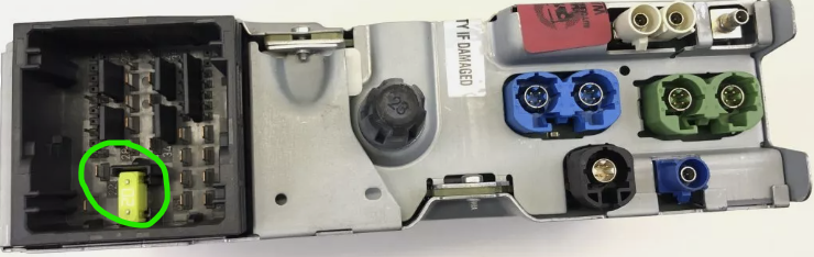

Ok. so just to advise that you don't have a full telematics system, you have an RCC (Connected Colour Radio) system.
I would of suggested checking the firmware version - but this will be impossible in its current state with a blank screen.
It may need a replacement unit (which is the unit that sits inside the dashboard that the display is connected to. But I do suggest you have it diagnosed first, as replacing parts is not always the situation, as you know from replacing the screen. This would rule out an electrical fault.
However there is one simple check you can do - make sure the fuse has not blown. I have indicated it circled in green below. This can happen especially if poor quality cables have been used connecting equipment to the USB port - cheap Chinese cables are the worst.
