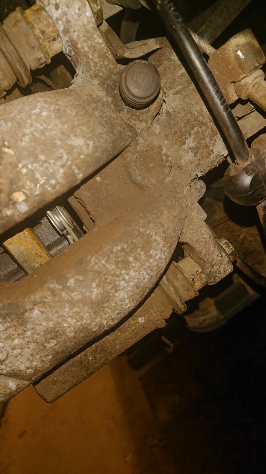

The pads should be correct. They're ordered on OE number(16 682 475 80). They're 16,6mm thick which it should be I think. Here's a picture

Re: Brake pedal to the floor - Berlingo B9
Unread post by PaulC5 »
Even if the pads were wrong, they are a lot thicker than the old so would not explain the pistons not pushing out. Your idea of screwing the pistons out might help, it is possible the internal auto adjuster has been affected when they were screwed in.
